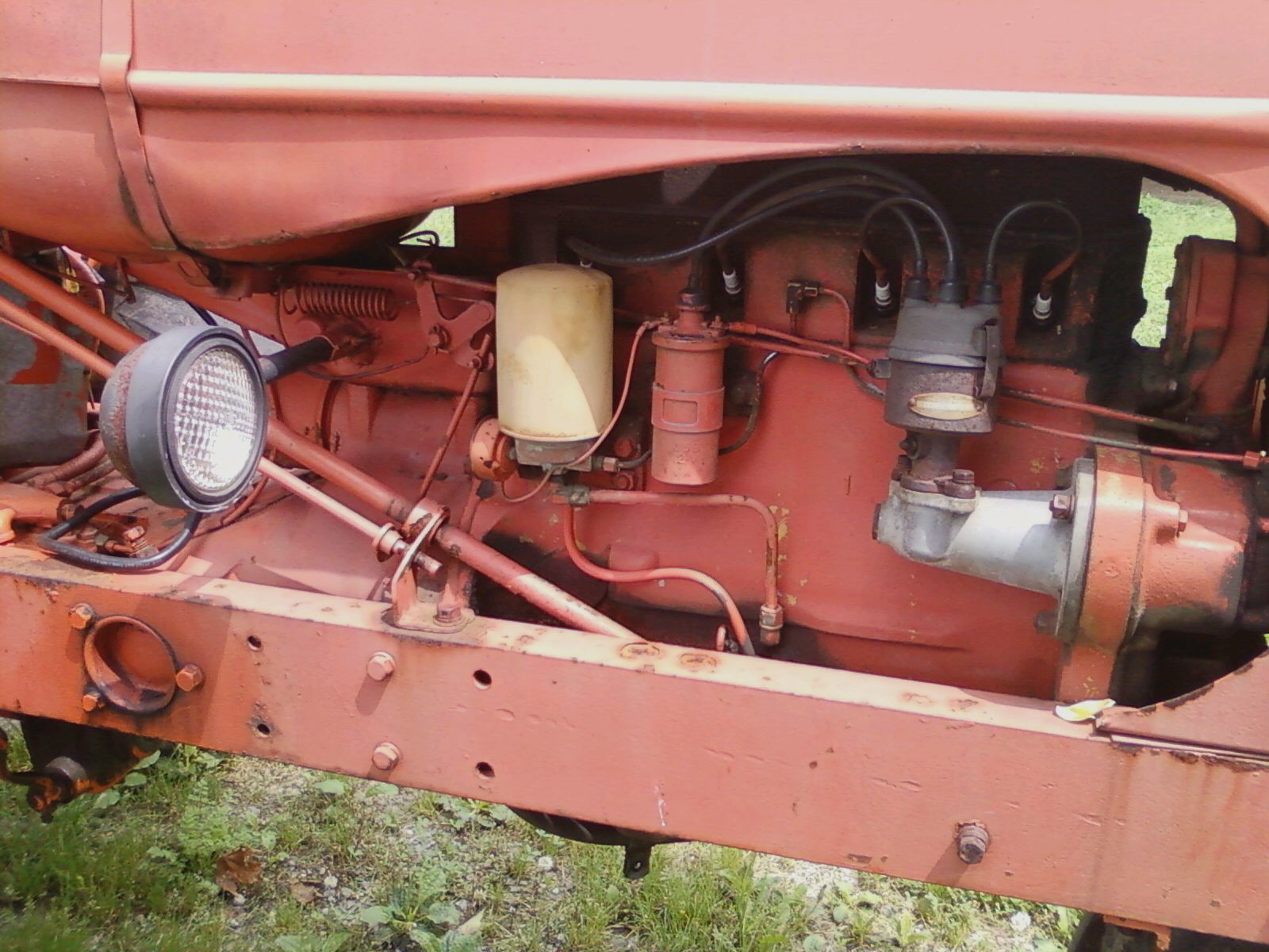

Post Options Post Options   Thanks (0) Thanks(0)   Quote timsWD45 Quote  Post ReplyReply Direct Link To This Post Posted: 17 Jun 2010 at 9:20am
Thanks for the replies.. I'll get 7 quarts (one extra in the garage) of 30w...
Ass for the oil filter.. it doesn't have any numbers and I haven't taken it off.. however.. please see the attached picture if you can identify..
1953 WD45 W/ D17 Engine
Points: 22371
Post Options Post Options   Thanks (0) Thanks(0)   Quote DrAllis Quote  Post ReplyReply Direct Link To This Post Posted: 17 Jun 2010 at 9:34am
Fram PH-8A or equivalent.
