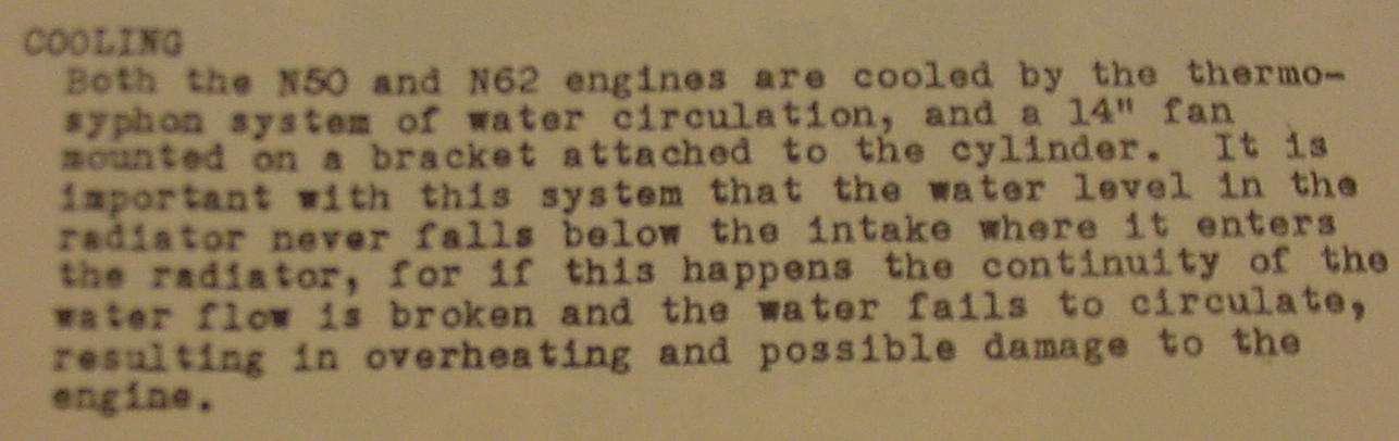

All that the Continental N62 Instruction Manual has to say about the cooling system.
