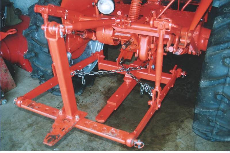

I have a CA pin hitch I would like to put a 3 pt on, can someone post pics of their tractor with the hitch please?

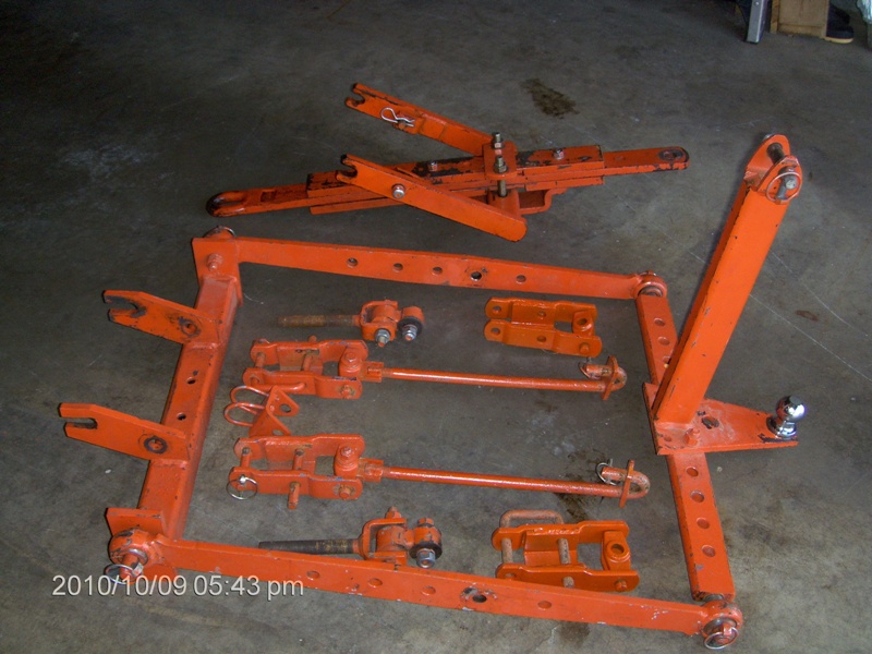

I have a CA with the Snap  couple system. It may give you some ideas to work with for your pin hitch setup.
I designed and had built the first bracket and bought the arms & draw-bar to fit. the lift arm brackets are early AC components. I also had to make a top-link bracket for the lift arm shaft.

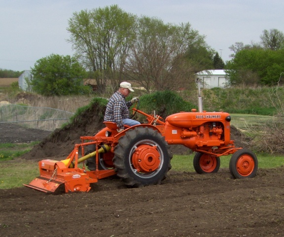

The 2nd hitch is from an AC plow hitch that I had 3-point eyes welded onto the ends for the draw-bar. I also use this hitch for using a 4 foot tiller.
Hope that this will inspire you to design your own system!
DeWayne

I'd like to see that myself. Since the pin hitch set up uses the lift arms for the drawbar bail, you can't have a drawbar  on it with a 3 point hitch.
 It might be easiest to go with a "wishbone" style 3 point .
 OK tractor has one that will pin up to the early CA. Notice the insert in the lower right corner. http://oktractor.com/zen/index.php?main_page=popup_image&pID=204
