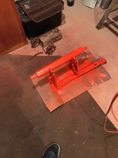

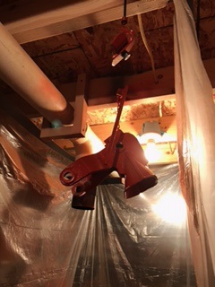

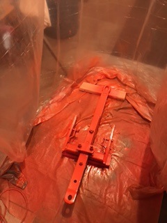

It's been a while (about a year) and I am having trouble finding the pictures I took before I took these parts off of the tractor.  Does anyone know how (or better, have pictures of the assembled parts).  Sorry these pictures are not the best,  I forgot to take the photos, so had my son run out to the barn this morning and take them and send them to me before he went to school today.

One to the left is your "bell" part of the snap coupler hitch, goes down under tractor and the drawbar in the middle pic goes into that. Pic on right is the hitch for a 80S sickle bar mower, unless you have the mower it doesn't belong on tractor, and won't go on together with drawbar.
