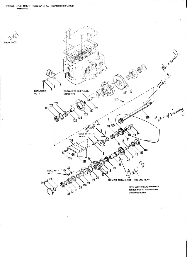

I have a noise in the rear PTO and think it is missing a thrust washer (13) and metal washer (14) in the drawing.]Should have the parts in a week or so. Thanks to all.
Can any one help with the missing parts?

720 allis  chalmers , im also looking for the splined hub that slides on to the shaft that runs the pto ,part 126 in garys diagram, any help finding it would be appreciated . brad in saskatchewan.

Just to confirm that it's part number 126 from the drawing that you need.
The hub from my 9020, looks to be made from cast steel, the manufactured hub will be much better with a case hardened spline.
Edited by rustydollar - 22 Aug 2017 at 12:27am

The hub and pto shaft that go through the transmission were both found to have the splines worn on my 9020 a sister tractor to the AC 720.
The machine work is being carried out in a shop located in British Colombia.
Here's what the hub looks like in 3D.
