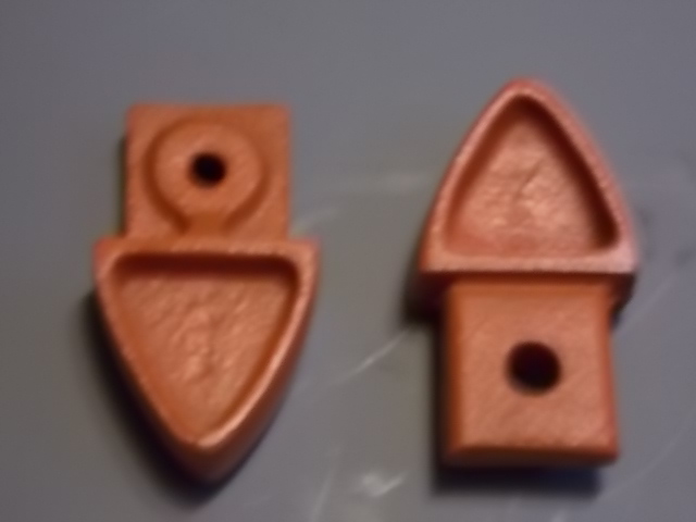

Quite the handy item you have there now. If anyone wants to make a replica one using channel iron or needs to replace a point or two, I have new points for sale. $35 each plus shipping.
