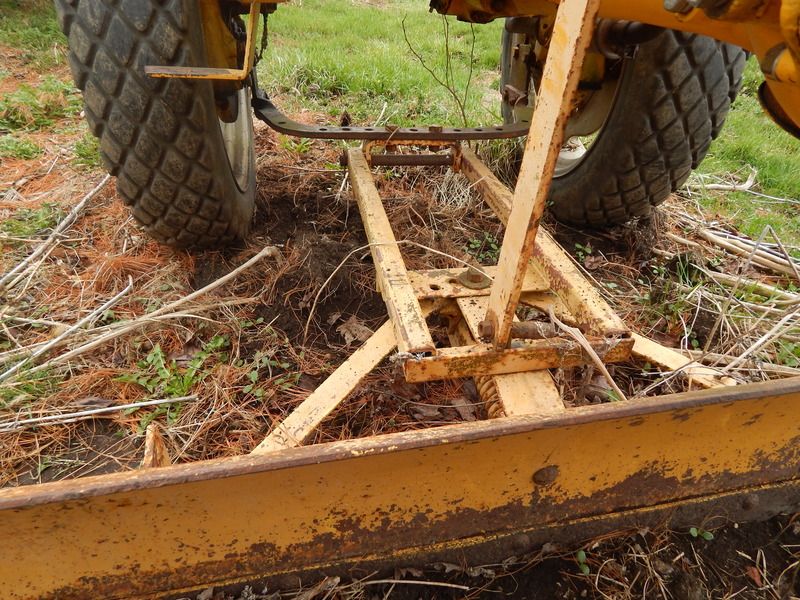

Use the idea that Farmall cub uses on their under blade!----simple made and does nice work!---I have one under one of my cubs right now.
You will do good with the under mount!

Post Options Post Options   Thanks (0) Thanks(0)   Quote ac fleet Quote  Post ReplyReply Direct Link To This Post Posted: 26 Mar 2017 at 10:29pm
Ya want pictures of my cub setup???---- Will gittum tomorrow and get them posted up for you.---It's an idea that could be adapted to any size blade or any color tractor.---Just scale it up to whatever size you need! thanks; ac fleet

Post Options Post Options   Thanks (0) Thanks(0)   Quote ac fleet Quote  Post ReplyReply Direct Link To This Post Posted: 27 Mar 2017 at 8:07pm
Took some pics of the cub blade between rains!
Here is one from the front, it gives a fairly good view of how its made and hooked to the tractor.---got another one from the back.
Finally got p-bucket to give me the pix.!!!
 thanks; ac fleet

Post Options Post Options   Thanks (0) Thanks(0)   Quote DaveKamp Quote  Post ReplyReply Direct Link To This Post Posted: 28 Mar 2017 at 6:48am
Wow, Fleet- that's a cool setup... yes, simple, and perhaps a little on the lightweight side, but for a Cub, that's to be expected.
Some variety of that was kinda what I had in mind. The hydraulic version above looked right, but the pictures were a bit small for details.

Post Options Post Options   Thanks (0) Thanks(0)   Quote ac fleet Quote  Post ReplyReply Direct Link To This Post Posted: 28 Mar 2017 at 11:36pm
Ted!---You could use this as an idea to work from!---Just scale it up to whatever weight your tractor needs!---the idea can be adapted to any color or size tractor.
Nother' idea I have is to start with this STYLE setup,---THEN add a long cylinder on each side for seperate control of the blade---- angle could also be a cylinder on a third valve! ----I got all kinds of ideas!!! LOL!!!!
If the cub had aux. hyd. ( which they don't) I would put each side on a valve/cylinder to control the blade!---for its size it does great job the way it is, just gotta take light cuts!  thanks; ac fleet
