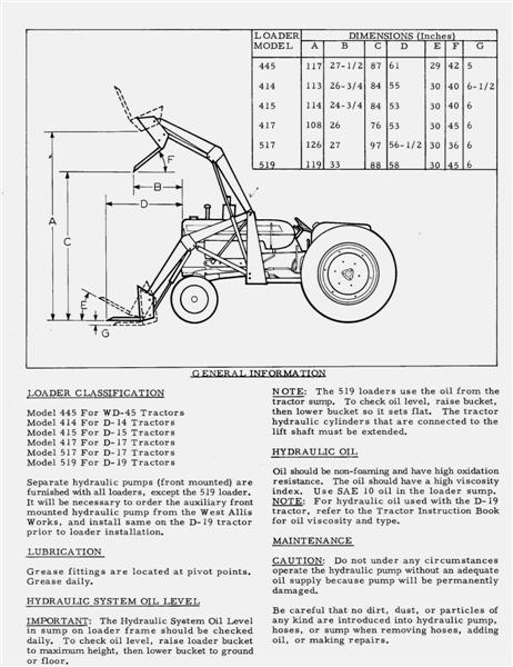

Here is some info from the manual on 400 & 500 series loaders.
Maybe it will answer some questions?

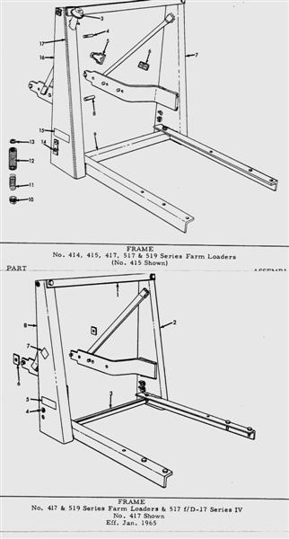

This may clarify or may add more confusion. Here are two diagrams of the frames.
Apparently in 1965, the loaders may have used the tractor's own hydraulic reservoir rather than the frame tower on the D-19 and D-17 (series IV)?

According to the parts book, the 400 loader could have the reservoir in the frame or not. The frame mounted tank was only needed with the front mounted tank.

Also, according to the manual, ALL 400 & 500 series loaders came supplied with the front mounted pump.
