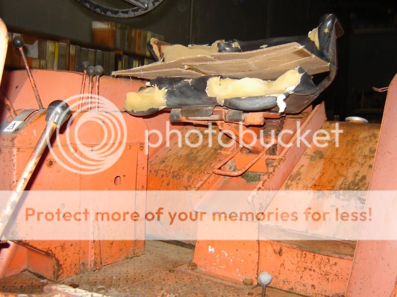

Post Options Post Options   Thanks (0) Thanks(0)   Quote DSeries4 Quote  Post ReplyReply Direct Link To This Post Posted: 14 Feb 2017 at 8:19pm
Referring to this picture, you will see a knob just above the floor panel in front of the tool box - that is the PTO engagement lever on my 1967 190XT.
It connects to the unpainted lever you see on the side of the torque tube...
Hope this helps.

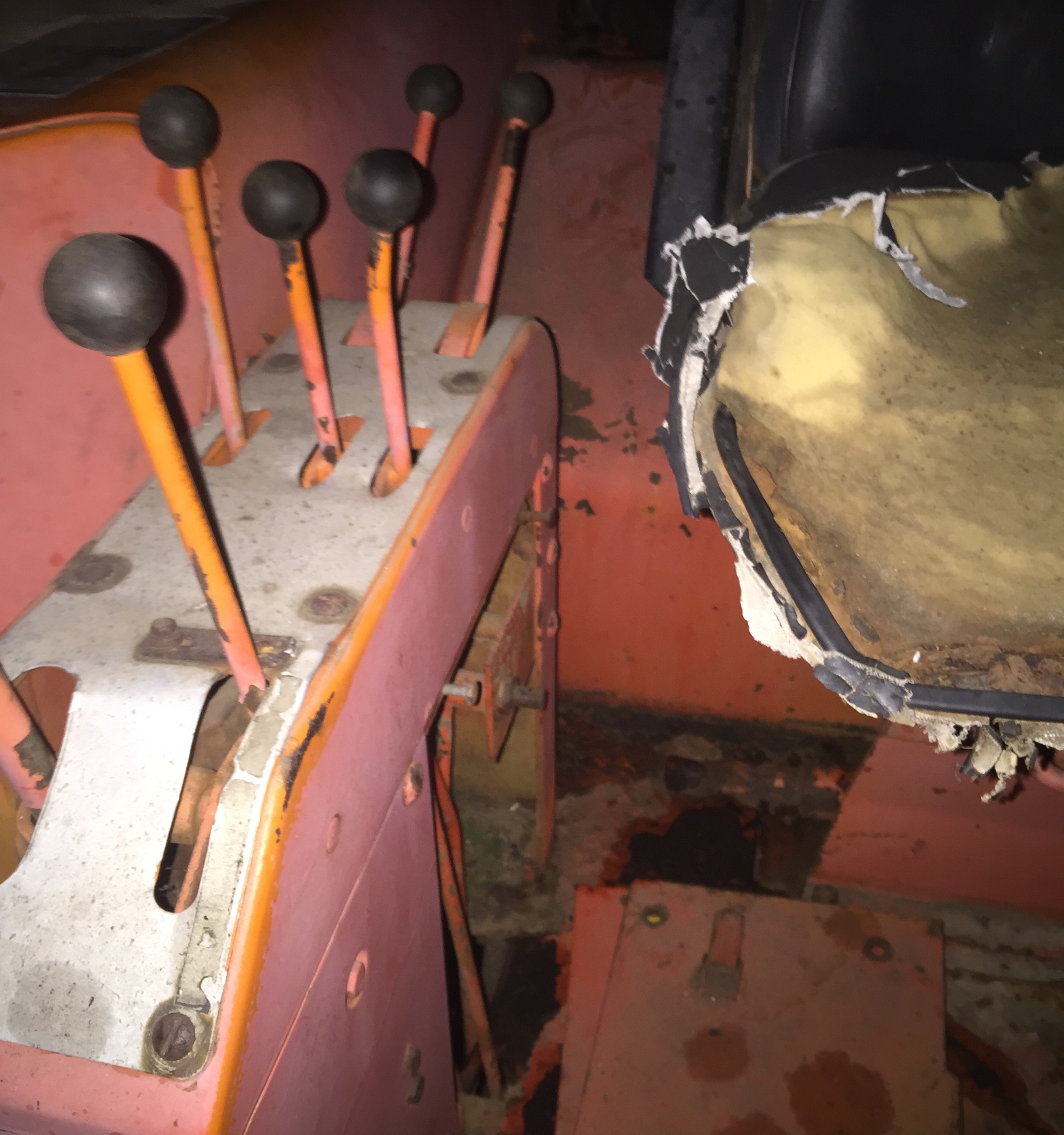

Post Options Post Options   Thanks (0) Thanks(0)   Quote Lonn Quote  Post ReplyReply Direct Link To This Post Posted: 15 Feb 2017 at 7:48am
Do you have a lever on the right hand console. Look at DSeries4 top pic. To the right of the seat, not quite halfway down the console, there is what looks to be about an inch diameter hole. His pic shows no lever at that hole but if you have a hydraulic PTO then there should be about a 6 or 8 inch long lever there.

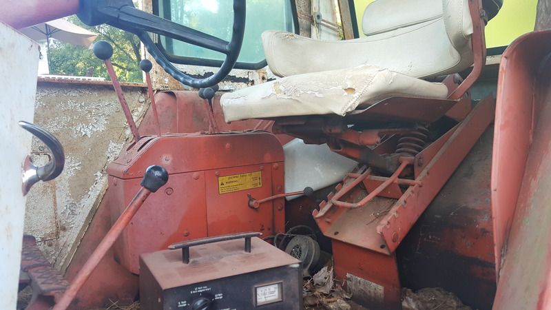

Post Options Post Options   Thanks (0) Thanks(0)   Quote Charlie175 Quote  Post ReplyReply Direct Link To This Post Posted: 15 Feb 2017 at 7:56am
PTO engagement lever on mine

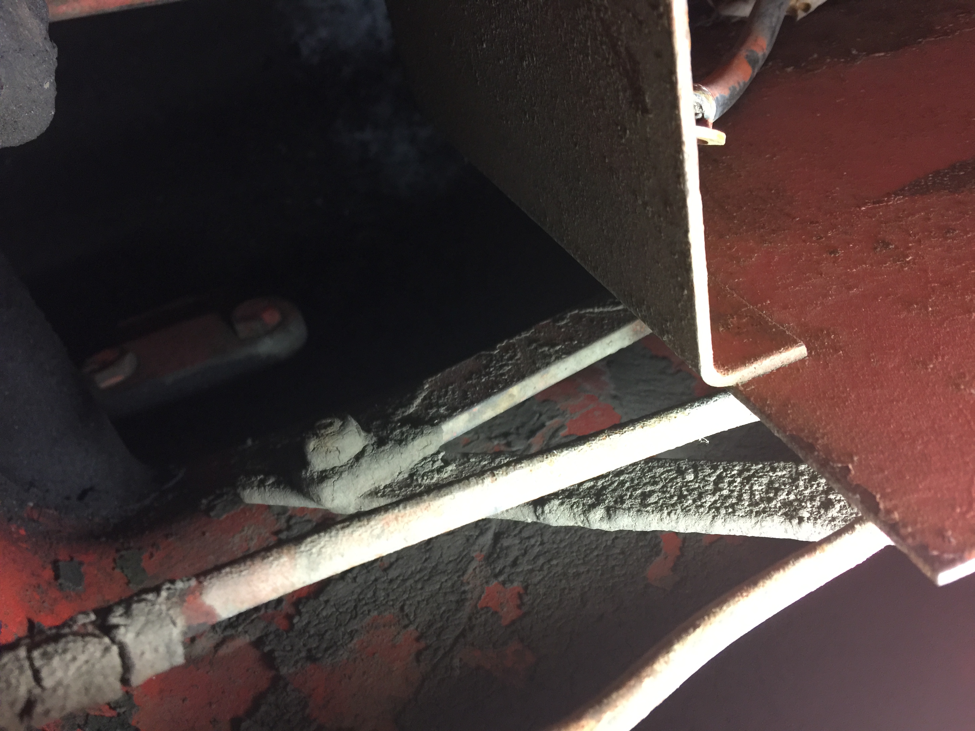

Post Options Post Options   Thanks (0) Thanks(0)   Quote Crashmarvin Quote  Post ReplyReply Direct Link To This Post Posted: 15 Feb 2017 at 8:04am

Post Options Post Options   Thanks (0) Thanks(0)   Quote Lonn Quote  Post ReplyReply Direct Link To This Post Posted: 15 Feb 2017 at 8:15am
You are missing the lever. The rolled pin sheared and it's gone. Probably the linkage and/or the valve is stuck.

Post Options Post Options   Thanks (0) Thanks(0)   Quote Crashmarvin Quote  Post ReplyReply Direct Link To This Post Posted: 15 Feb 2017 at 9:28am
Ok my original thought was that was the lever. For it. The linkage underneath was apart got that back together and with some penetrating oil and pipe wrench I got the pin to turn. Thanks
