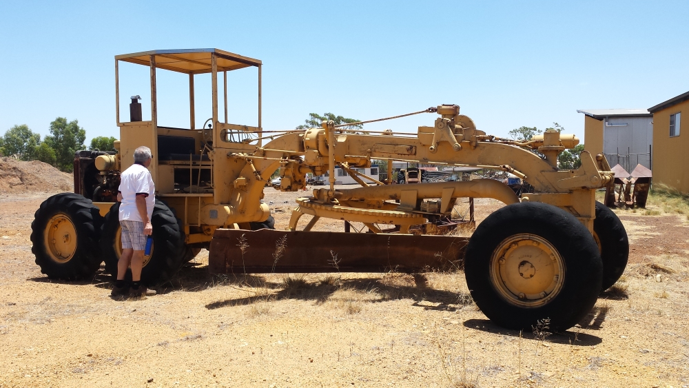

We're looking at buying an old AC 145 grader that has been sitting for a long time.
We managed to get the old girl running which was a good start. It looks like no one had taken a grease gun to anything for years and several of the universal joints need replacing.
My question is, does anyone know what size the cross/caps are for these machines?

Unfortunately the machine is over 100km away so we aren't able to easily get at the parts. Unhappy
The photos do it more justice than reality. It needs a fair bit of work & tlc. At some point in the past a Perkins engine out of a tractor was used to re-power it. This has created a few other problems to sort out as well.
Still, if we can get it for a good price, it should do us ok hopefully.
