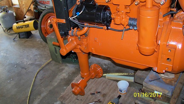

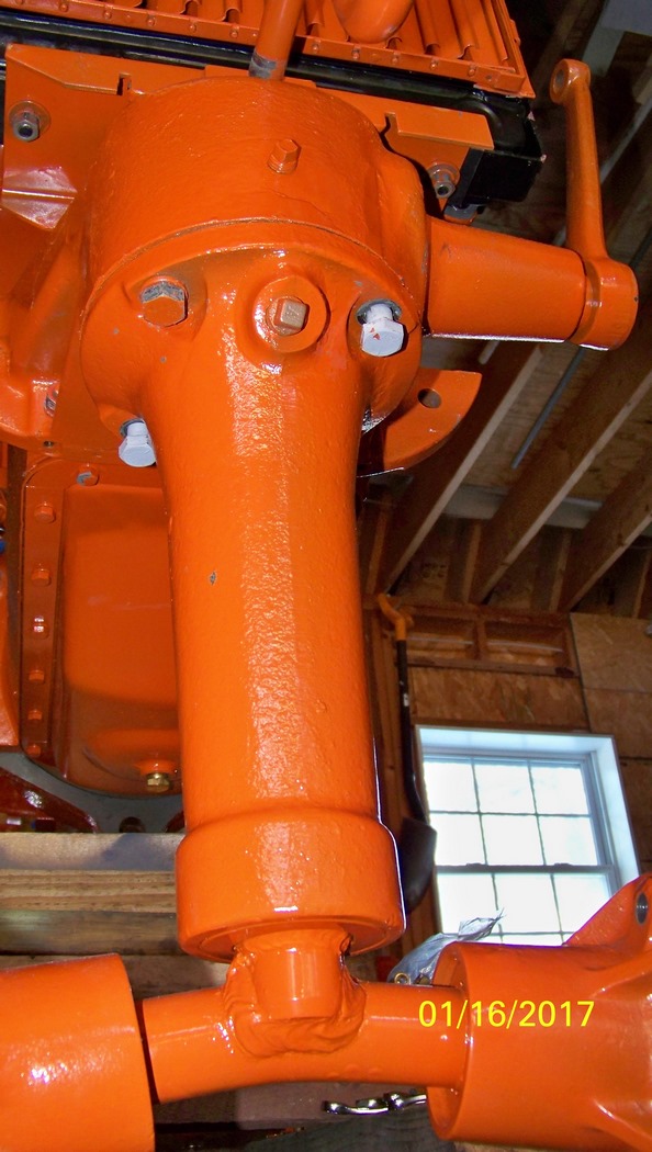

Do I have the front spindle on correct or should it be turned 180°.  I think its correct as best I can see in the manual.  Didn't take a picture of the front support when I took it apart.  Anyone should be able to figure out which way the front spindles are supposed to go back together and hear I am asking.   Its on a 1944 Model c, now lets see if I can remember how to load pictures.  Thanks Guys in advance.

You have it correct.  the other way around will cause wobble. Think about how a castor works. The wheel trails the pivot point.

I had to think about what you said about the caster wheels and yes they are always following the pivot point, wonder if I will remember that next time.
