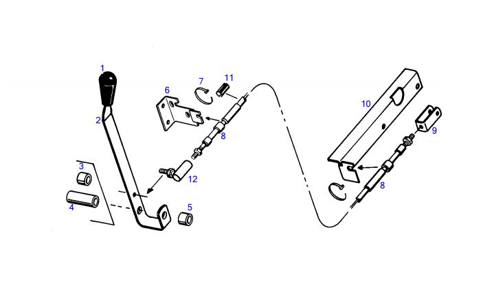

I am not the expert, but it could be a problem with a bent bracket, #6 below:

That #6 absolutely cannot be bent rearwards at all !! I have straightened many over the years and welded in a brace to keep them from bending again. Steady hand pressure to release....not just force it.

Thanks for all your input guys, I had it out again tonight to move more snow and did like the Dr mentioned I firmly but slowly pushed the lever and with the lift arms up it disengaged. I guess like any cable it can't be forced. Thanks again for the help!!
