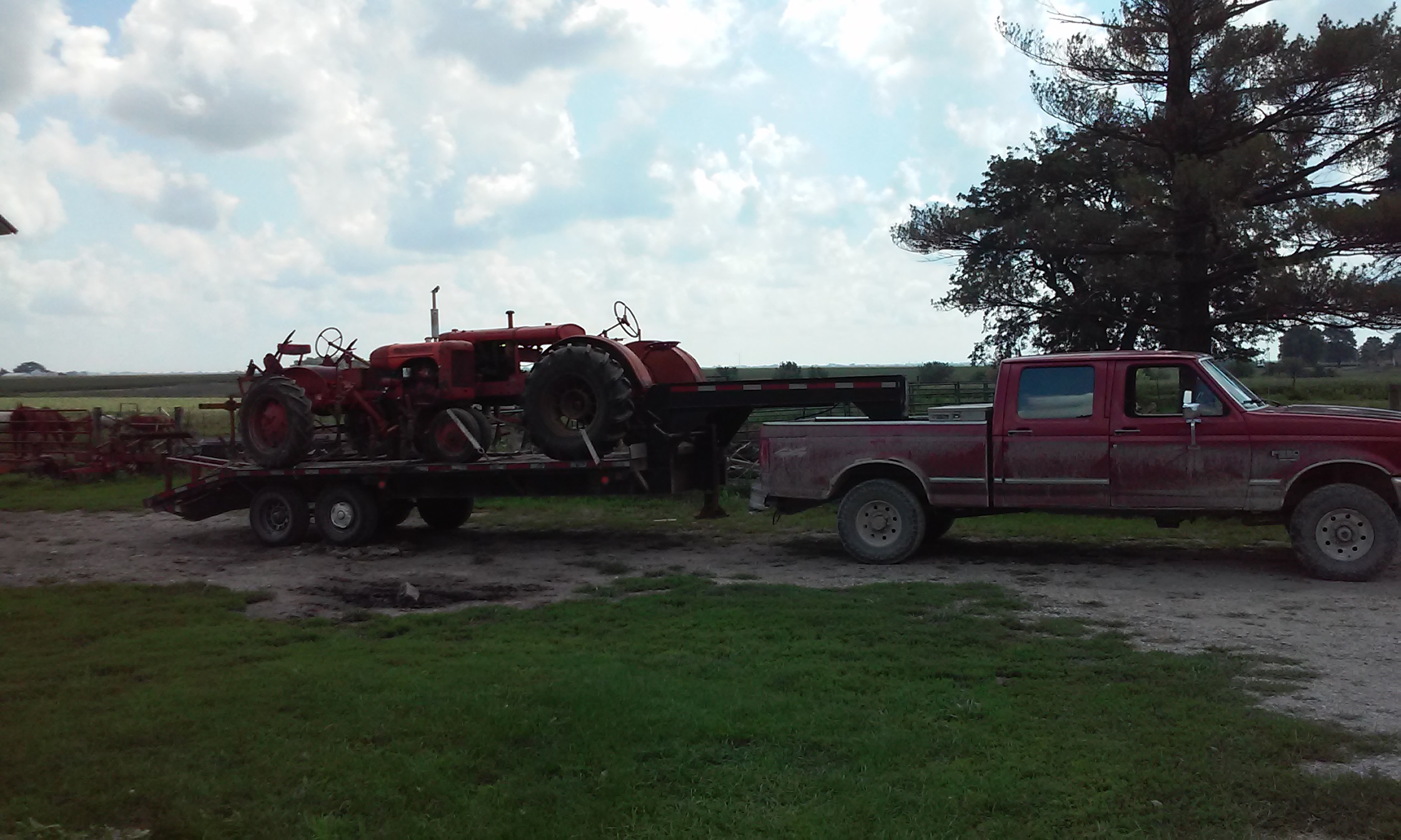

Did it with my WC and my boys C.  Backed the WC on, turned the front to one side a bit, then drove his C on and turned the front the opposite way as the WC. 7' may feel a bit narrow, but it should be just fine.

This is how I did mine.

The trailer in my picture is 16'. I'd have had more room if the C didn't have the front cultivator bar on and if the WC had the tires spin narrow. WC with the C parked tight in the garage needs just under 15'.
