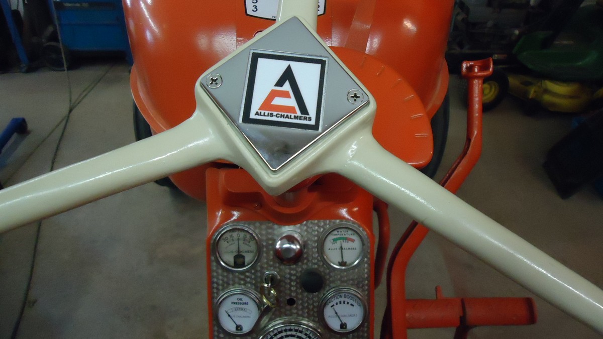

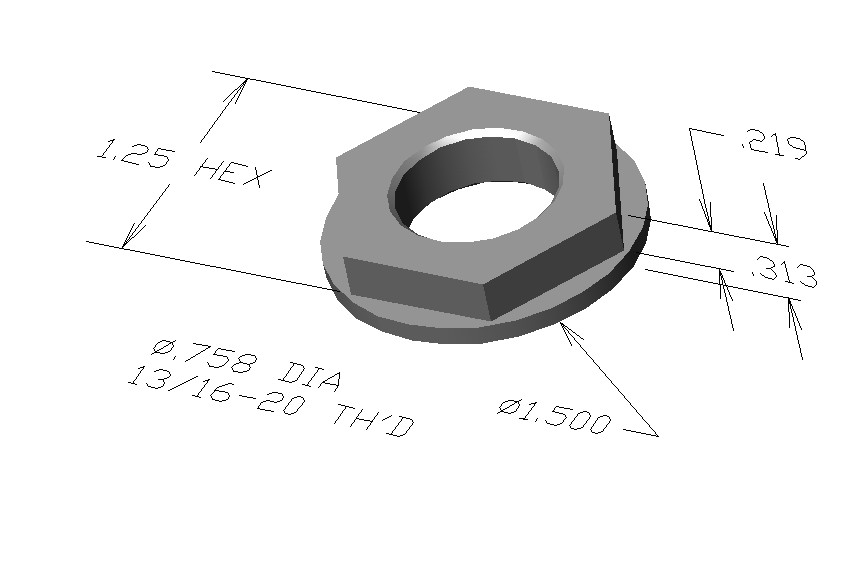

Changing out the steering wheel and have a few questions. What color is the steering wheel supposed to be on a 1967 d17 series iv? Cream or white or black? Which cap is supposed to be on it? What size is the nut on it?, I think I'm going to have to split the nut.

Steering wheel should be cream. If the old wheel is junk, a little heat would convince the nut to come loose. The cap would be the late style decal in the center

Steering Wheel and Emblem or cap;
Flanged Hex Nut;
DSeries4 View Drop Down
Location: Ontario, Canada
Points: 7569
Post Options Post Options   Thanks (0) Thanks(0)   Quote DSeries4 Quote  Post ReplyReply Direct Link To This Post Posted: 31 Oct 2016 at 9:23pm
Gatz is correct!
