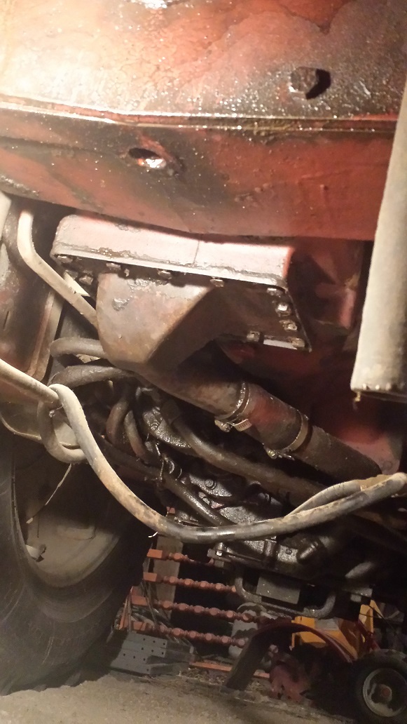

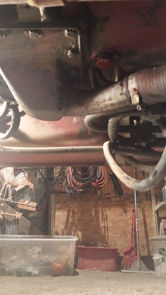

I want to change the transmission oil on my 7050. When looking at the Operator's manual it states that there are two front transmission drain plugs. I only see one. I've included a picture of the page in the Operator's Manual and my tractor. My tractor does not look the same as the Operator's manual picture shows. Also, the pump screen cover plate at the rear of the transmission doesn't look the same as in the manual either (I don't have a picture of that but I can get one tonight if I need to). Thanks in advance for any advice.

There is the front plug which you have in your picture then there is a back plug below the right rear axle.
Also there is ~2 gallons of fluid in the PTO gear cavity above the rear cover plate as well that does not have a drain plug to get it out.
For that I would recomend drilling a ~1/4" hole about 2" in from the rear and left side of that rear plate to drain that then drill and tap the hole to put a 1/8" or 1/4" pipe plug in it.

What you have is an update from a newer 7060,called a sewer pipe system. There is one drain plug underneath the transmission (above the rubber hose) that takes an 1 1/8" wrench, and one of the four 3/8" bolts at the bottom has a special flat washer on it and is the lower drain. To access the screen for cleaning you need to remove that sump and cover plate. Use good adhesive on both sides of both gaskets and let cure before refilling with oil.

Ok, thank you for the quick responses. I appreciate the knowledge you are willing to share.
