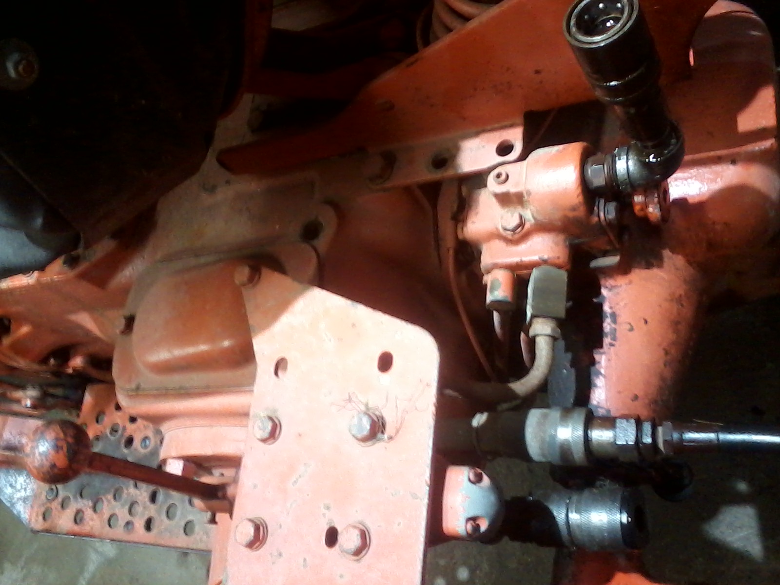

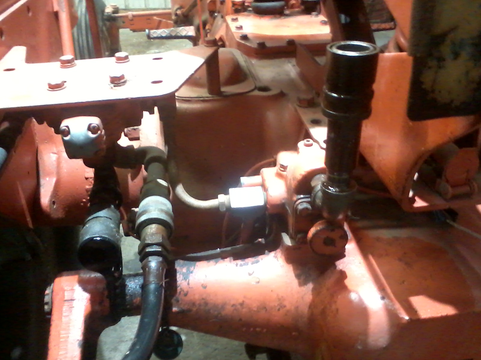

You say there is "a control valve/lever on the left rear by the remotes". Remotes to me means more than one coupler, and a D-17 of that age only has one coupler, not two. So, I think you have an operational problem, a two-way valve and/or the previous owner has it plumbed up wrong. If you aren't losing hydraulic fluid and gaining transmission oil, there isn't a problem with a hose or seals internally !!! A picture would be very helpful.

The control valve lever I mentioned in an earlier post is the transport valve. Sorry our D15 didn't have one. I am learning! Hooked into the other quick disconnect and tried lifting discs (10' transport) and it works great. Just the lift arms wont lift the plow up more than a couple inches. I am thinking still the pump is fine or it wouldn't lift the discs. Maybe I am wrong. Will post a couple pics tomorrow.

There are 2 disconnects on a valve with lever. To the right is a single disconnect. I think someone put the second one on the left, not sure.
Points: 21910
Post Options Post Options   Thanks (0) Thanks(0)   Quote DrAllis Quote  Post ReplyReply Direct Link To This Post Posted: 02 Jun 2016 at 4:54pm
Now, that we have established there actually is an "added-on two-way valve" (non-factory), how do you make your lift arms raise??????? Are you activating this lever on the added-on valve and then the arms lift up??
alan1959 View Drop Down
Joined: 15 May 2016
Location: Avoca, Michigan
Points: 22
Post Options Post Options   Thanks (0) Thanks(0)   Quote alan1959 Quote  Post ReplyReply Direct Link To This Post Posted: 02 Jun 2016 at 6:44pm
Problem Solved!!!! The hose was hooked to the disconnect on the right. So I unplugged it and just plugged in to the middle disconnect, just to keep it clean and it works perfect! Thanks so much to everyone for their time and effort!!
