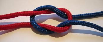

In a proper square knot each line and its tail are adjacent. Yes they twist in opposite directions. In a granny knot that is considerably weaker, they are not adjacent.
Square knot.
Granny knot.
