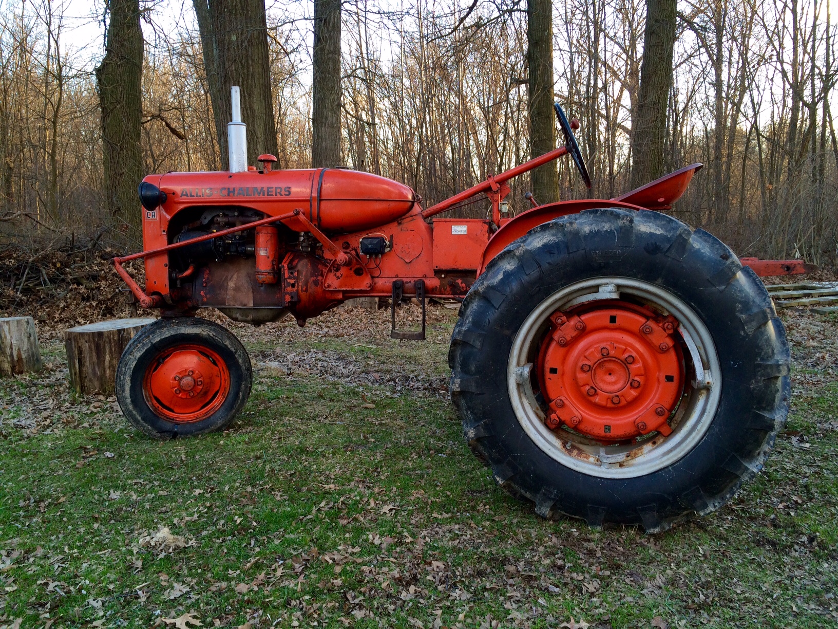

Hey guys,
A little background on my stumping issue, I have posted before about it and have worked out most of the bugs... but i still have this continuing issue. (check my prior topics if you want more background, i'll brief it here)
1951 CA, willed to me from my grandpa and it sat for 6-7 years. As far as I know it ran when it was parked. The tractor has a 12v conversion with 12v generator, regulator and a 12 v coil.  After troubleshooting, it has gotten the following new parts; intake/exhaust manifold/gasket, plugs, cap, rotor,  wires, coil (correct ohms for this motor per the forums), points/condenser, carb (re manufactured), all fluids. I have also adjusted the valves, checked gas flow in carb, ran with gas cap off, ran it at night (checking for jumped spark), checked timing several times. I have also ran new wires from ignition to coil and solenoid.
When the tractor is started up, it runs fine. After running for 15-20 mins, it will randomly spit and sputter and hunt when at 3/4 - full throttle. If you back the throttle down it will correct itself. If it dies, the tractor will start right back up at idle, and run at 3/4 - full throttle, but never fails if the throttle is above half, it will spit sputter hunt and try to die. I do not believe its the coil because the tractor will fire right up after it dies and it doesn't seem to effect it when it dies. There does not appear to be any sediment in tank, carb was ok the last 3 times i pulled it apart. Checked flow, etc.
I thought i had it fixed after new points/condenser because I ran it this winter after replacing points/condenser and it did not spit, sputter, hunt/die. That was when the temp was 15-30 degrees F or so. It 65 here today, and was in the 50s and it did it again. The choke does not fix the sputter if pulled when dying. I even messed with the timing thinking it was too far advance, but no chance. I am in the process of getting a light to get it exact again. I did alot of it by ear, and got it pretty darn good before.
Any ideas? I checked the metal fuel line near the block it was somewhat warm but did not seem warm enough for vapor lock. I thought about ripping the distributor apart, but that wouldn't explain the temp issue. I am pretty mechanically inclined and have worked on a lot of things before, but this thing has me pulling my hair out.... I want to keep this thing for around my future cabin planting food plots and such, but not the way its running...
Edited by bigredneck61088 - 16 Mar 2016 at 4:55pm
