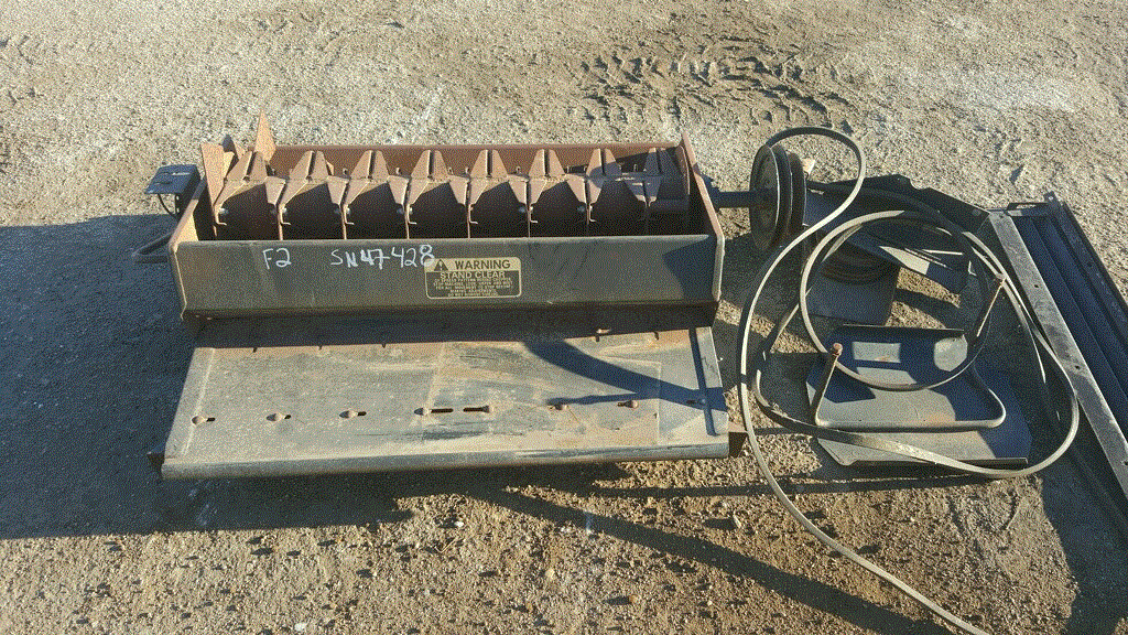

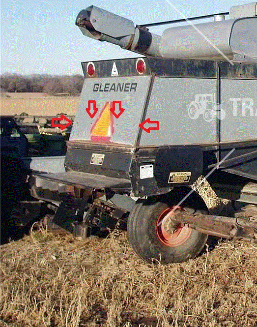

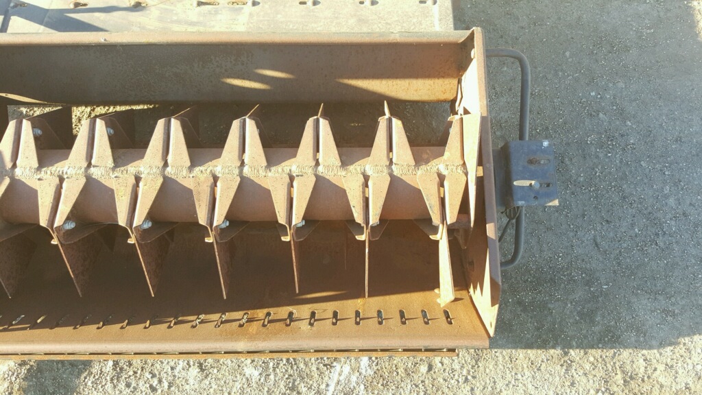

Just bought a Gleaner F2, (gas) with air flow grain saver, 13 flex and 4 row corn head, for 1,500.00, runs great, interior is mint, drove it 70 miles back roads to get it home. Just noticed that it originally had a spreader on it. someone decided to put a chopper on it, but its not an F2 chopper its a chopper off an Gleaner F, I have located an F2 chopper but looking for any info, pictures, measurements, any thing on the (Corn Kit) above straw Chopper, I do now know that how to tell if it has Corn kit - if there 4 bolts near center of the back panel, it has the corn kit shield, any info would be great.

You may want to invest in an F2 operators manual? Manual shows everything that you're questioning. Chopper Corn kit (I think- trying to remember?) includes;
1. Four protector plates - one for each straw walker's rear tin works. Plates protect against cobs that are thrown from chopper blades back against rear of straw walker tin.
2. Special angled divertor shield that replaces standard smooth shield that mounts utop the front of chopper, right under rear of walkers.
3. Two pulley chopper drive sheave. One smaller pulley runs chopper fast speeds for beans or wheat straw. Another larger pulley runs a slower speed for corn.
4. Straw walker canvas curtain that mounts about 3' from rear of walkers.
The chopper knives have a tendency to throw corn cobs back into the walker area. Corn kit helps control this tendency.

The most important piece is the curtain which hangs over the centerline of the chopper. We always backed over a 55 gal drum, removed a half dozen bolts and removed the chopper with a 4 row head. You will not notice the difference and will save big buck in the long run due to chopper / thrown cob issues. Just tie the belt back away from the main clutch shaft drive pulley. IF you choose to run the chopper make sure the kit is in. We found leaving the rear shield in caused some blockage in green stem soybeans where the cylinder does not crush the crop. As in any chopper - the knives must be in like new shape - almost no wear allowed.

Thanks to this site found a barely used chopper with almost new knifes, new concave teeth, all brackets, pulleys, new belt, for 400, and most of the corn kit - curtain #37, rod #38, welded shield #35 with reinforcement bar #36, and #40 back shield which looks nothing like the drawing in parts manual, I don't know if i'll need the #39 walker shields, since my straw walkers are damaged and will be replacing with aftermarket Lip Type Louver walkers "Thanks guys"
