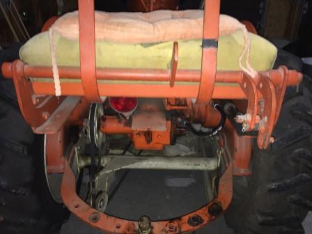

I do have a question about the hydraulics though.  The ram is currently attached to a bar that runs right behind the seat cushion.  What would that have originally been used for?  I would just ask my wifes grandfather, but, unfortunately he passed back in the spring, which is a shame because I would have a million questions to ask him.

The bar is to the upper 2 snap coupler's link connection.

Plow lift.

The bar that runs behind the seat with the ram attached to it is what I called the lift shaft.  Most major implements that were used by the B, the plow, cultivator, sickle bar mower, and others got their lift from this bar or linkages attached to this bar.  On the real early B's even the hand lift used this bar or a similar hook up to lift the implements.

Here is the bar I was talking about:

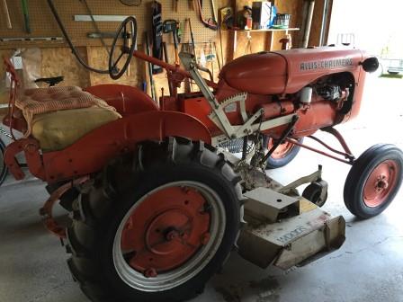

And another one of the whole tractor:
The tractor is pretty dirty on the underside and in the less visible areas, whats the best way to clean it up, take off the hood and grill, can I wash it like I would my car, blow it off with compressed air?

Brad that's a good looking B and it's obvious that your grand dad took very good care of it. When you described it as "been sitting under a tarp for some years"I was expecting to see one in poor shape. Mr Long is 100% right when he says it is a very special tractor. I also own a B s/n B26240 It was the first AC tractor for me and has a special place in my lineup.      Mark

Wow that tractor is in amazing shape. Yes you can wash it just like you would a car. A good engine degreaser from a parts store or that pink stuff which is all over the place for cleaning grease will help remove old oil and dirt grime. A steam cleaner that you rent works really good to clean them up just be careful not to get too aggressive with those they can peal off old paint if you try hard enough.

Seems to be that a lot of those B's were "Frankensteined" back in the day just because they are so common and parts so interchangeable.
My B is also like that; I built it out of the spare parts I found around the farm after my brother restored one. It is a 1944 rear end with foot brakes and electric start torque tube but is hand start because the only flywheel I had was one from a stationary unit with no ring gear, block is one of the earlier small bores with dished pistons that I pulled out of a guys shed and the head I just found in the shop that was left overs. Half the sheet metal is yellow as it came from an IB and the rest is from who knows where. The front wheels are off the back of an old WheelHorse because I didn't have regular ones and the throttle linkage (coming off the stationary and being too short) I extended by cutting and welding a metal fence post in the middle. Not pretty but sure has lots of character!
So, in my book your Frankenstein B actually looks really good! Nice find!
