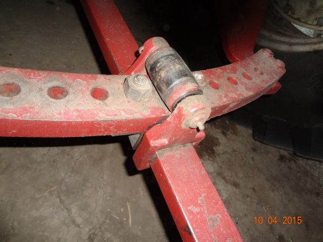

Anyone done this?

nope....I gotta be able to move mine each way!

for pto work a drawbar needs to be locked in place...

Our D17 IV 3pt hitch has clevis pins for quick removal, in lieu of the bolts in the picture above. Drawbar may move 1/2" back and forth, but nothing to worry about.

Looks like a good idea you came up with. I did something similar on my 200 after the square headed bolts became worn. I know some guys like the drawbar to move sideways just a little but never knew why. I like the drawbar to be 100% solid and rigid with no side movement at all. You don't want the hitch on your truck to be loose and flopping around so why on a tractor?

On my 7000 i have to slide the drawbar all the way over to clear the deck on my 3pt brush hog. Also nice If your pulling something offset like a baler or pull combine.

Makes it much easier to hook up if you can swing draw bar to side then into implement.
 That is why the PTO has ujoints.    MACK

yep...what Mack says, so much easier to hook up implements that you can't wiggle by hand!

One of my 175's has bolts with bigger heads that just drop in the holes. Drawbar has very little movement, but bolts can be easily pulled out to move drawbar in either direction.

I've gots rail road spikes in one of my tractors drawbar, the big head don't let it move much, and like Eldon's, can pull them out easy to move it.

This setup is for making hay with a round baler.
Up north we sometimes have swaths so big they roll up under the tractor and start pushing the swath in front of the tractor. This leads to more hay/chaff getting sucked into the rad and blocking the air flow.
Double windrows can be double trouble if you're not careful.
The 7000 is one of the few tractors with a lot of clearance under the trans, and with this smooth hitch system it makes baling that much easier…
Besides, didn't those original allis hitch bolts wear out fast, say 5000 hrs?   My 7000 has over 8000 hrs.

Yes-- the original square headed bolts did wear and cause sideways slop in the drawbar but the joke is the price of them if you want new ones from AGCO.

I can see your point, this set up certainly keeps those pins/bolts on the sides of the drawbar from catching the windrow!
