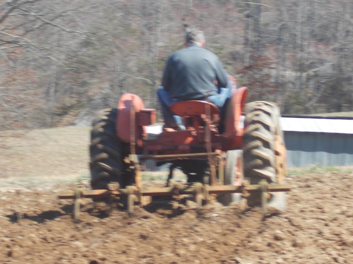

Does it look something like this. The levers adjust the depth the plow runs.

yes it does look like that but how does the quik attach part work   i will try and get some pictures of the brochure its kind of neet

My WD is pin hitch. The bracket hanging in front of rear wheels in the second picture holds front of the implement up. there is a link that connects to the traction booster hitch. The U shaped bracket on top connects to the lift arms
