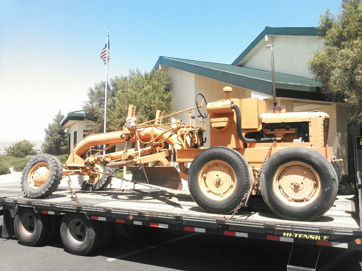

Hi everyone,

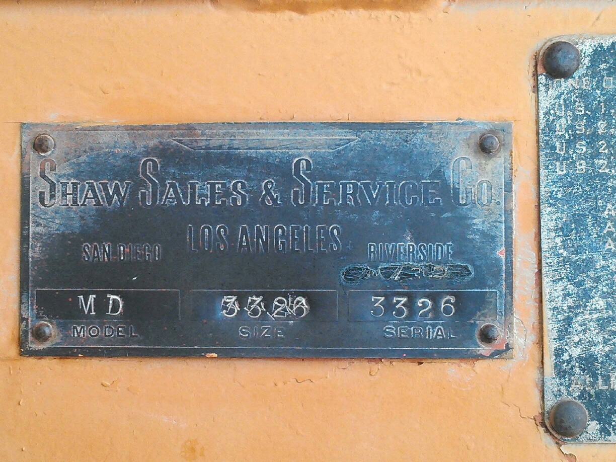

i am helping a pal try and find a starter for his model D grader that he just got.  the tag on the grader says model MD serial 3326.  it is a diesel but only 4 cylinder, i thought the D's had 6 cyl diesels.  is this motor something someone retrofitted or did some come with 4 cyl.  any help is appreciated, if a cyl diesel is standard does anybody kno what it is?  I am assuming it is a Buda.

That would make it a 1966 model year. It would have the same 4-cylinder diesel engine that was used in the D17D farm tractor or 175D farm tractor. Some of the vendors on this site should be able to help you.

thanks for the replies and thoughts. it is a round frame and looks 50's I would think. the serial number tag has been altered, as in someone cross checked the number and restamped (like maybe a dealership) I am new to this site and will try to figure out how to upload a pic or two to see if you fellas can figure out what this motor is.

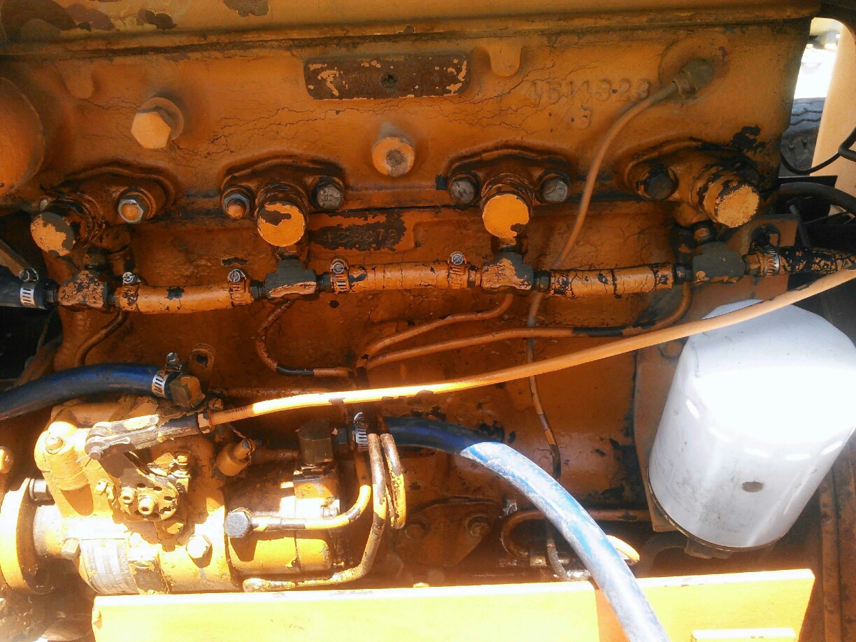

here is a pic of the injector and pump side. The pump is a Rossa Master again anyone that can help identify this thing is much appreciated . I did notice now that the tag has the name Shaw Sales, I am thinking the previous owner took this thing to Shaw and had a re-power....

Certainly looks like a WD45 Diesel engine, most definite an Allis engine. Would that interchange with a D series grader Gas??
Went back and looked at photo 1, has a WD series grill too.

He said that it was a 4 cylinder diesel so possibly not an Allis. It is a 4 cylinder engine in the picture. The sheet metal looks as if it might have been taken from an Allis tractor. It doesn't look like the typical D grader sheet metal. I am surprised that there aren't any tags or other information on the engine that would show the make. Those graders had a large adaptor plate on the bell housing so I don't think that it would be that hard to make up an adaptor plate for another engine. The same transaxle was also used in the small Galion graders as well and they may have had a 4 cylinder diesel that they used in their graders and someone found an engine from a Galion to put in their D grader..

The engine looks like a Allis Chalmers D175 4cylinder diesel.

It appears to be a D-175. Same engine as our HD-3 crawler.

Well thats a couple of folks who concur on a D175 i will find a starter for one and give it a try... thanks for all the help. If anyone has a tell tell sign to identify as a d175 let me know what that is and i will look for that.
