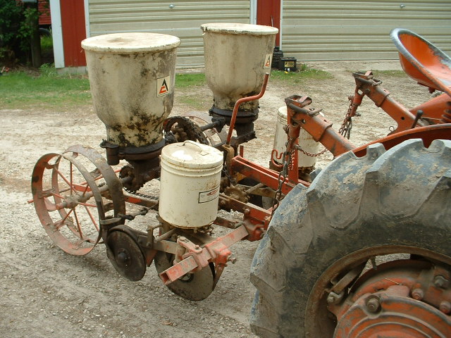

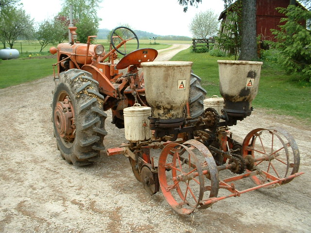

Don't know if this will help you at all but here's a video of my dad using his behind the D17.  Also some pics of it mounted on our CA.

It works well.  It is a plate planter so you need well graded seed with the proper plates and can't go crazy fast.  It has planted corn that has yielded 200 bpa.  In fact, here is a video of corn being picked that was planted by that very planter.  You can see for yourself how well it works!  Sorry for the tractor powering the picker.

The difference in the WD and CA markers is that the WD markers raise when you lift the planter. On the CA you have to do that manually. If you look at the picture of the planter on the CA, that is a WD planter with the extra chain that connects to the latches. LOL Bob
