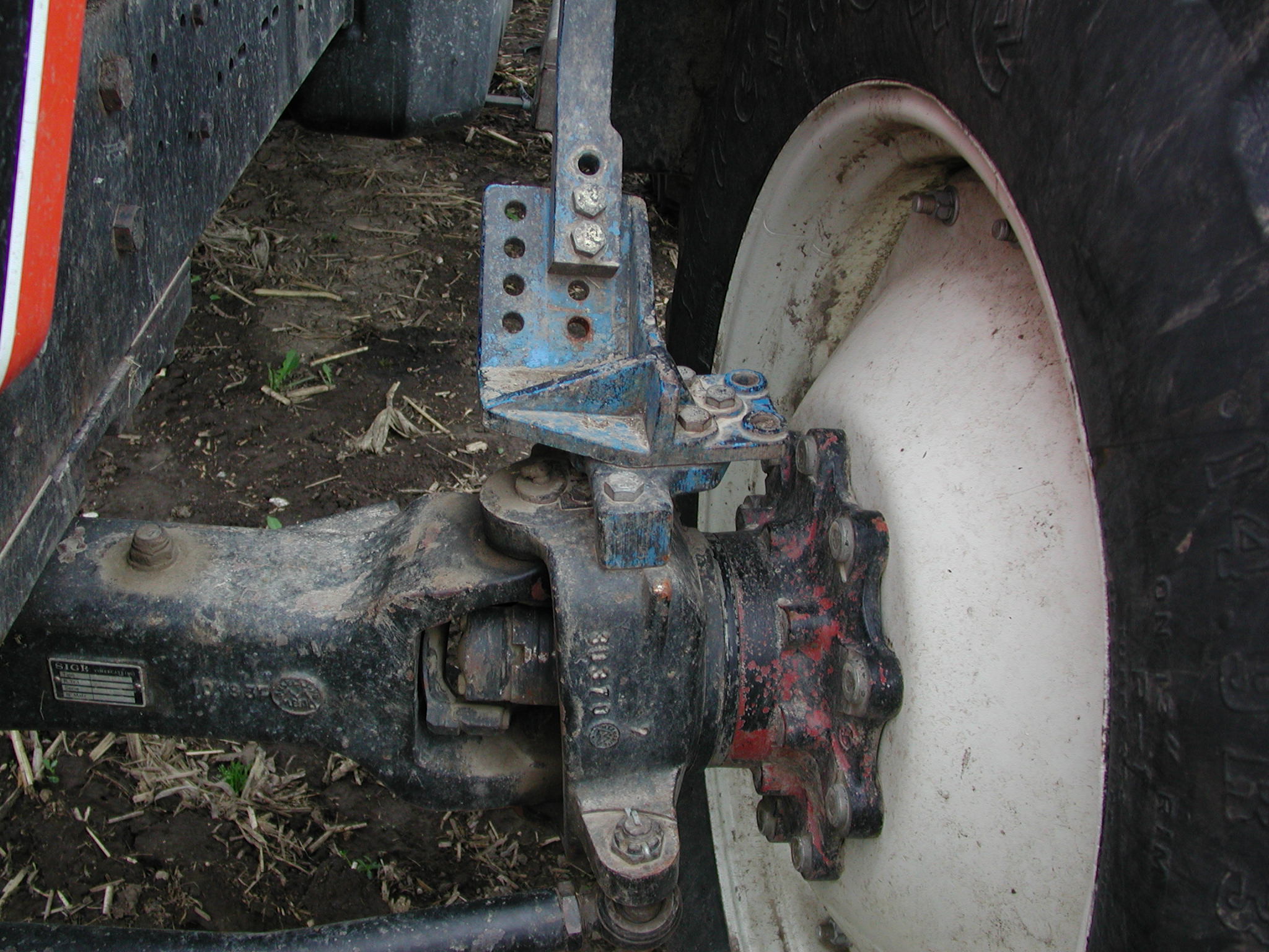

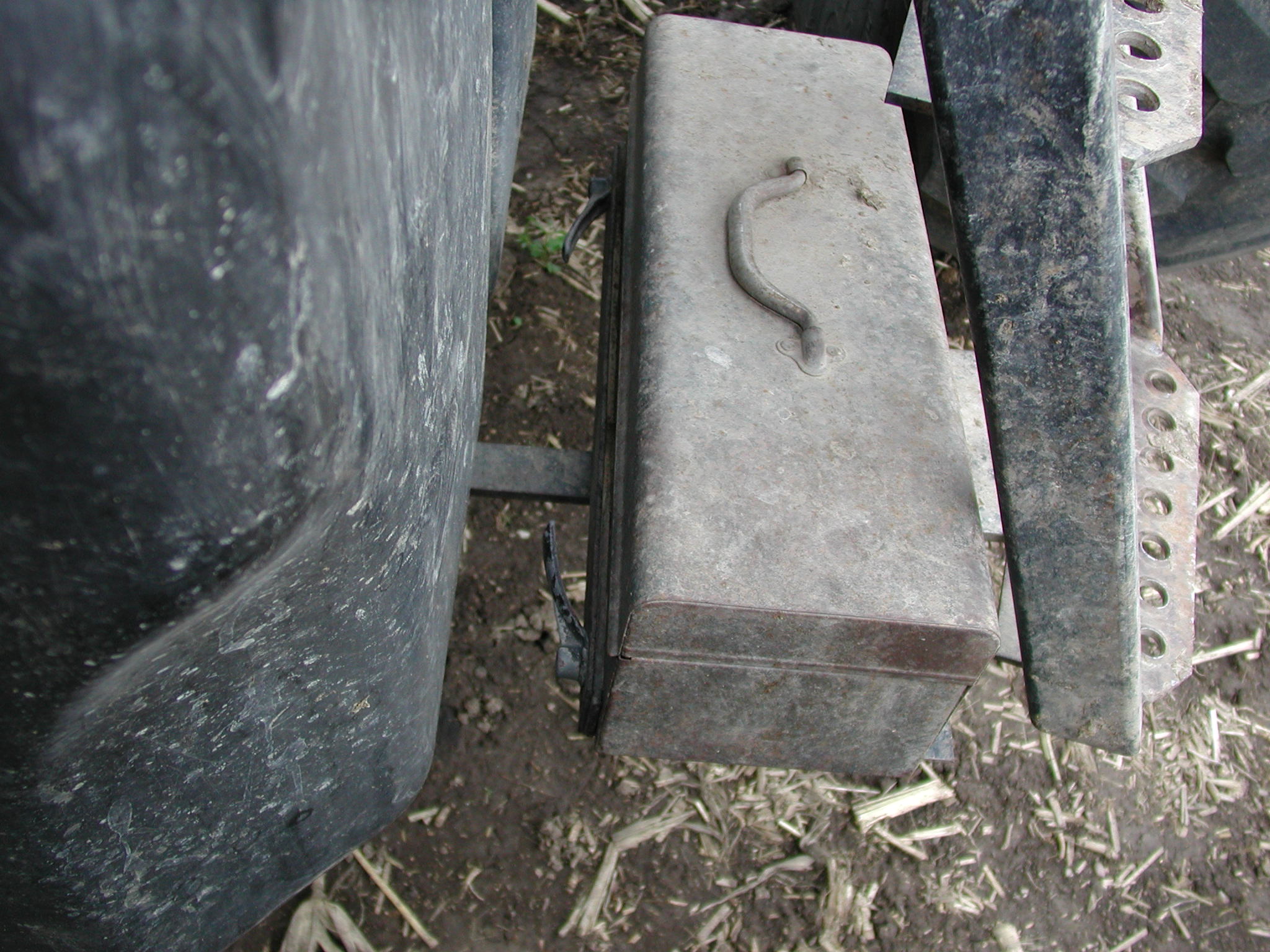

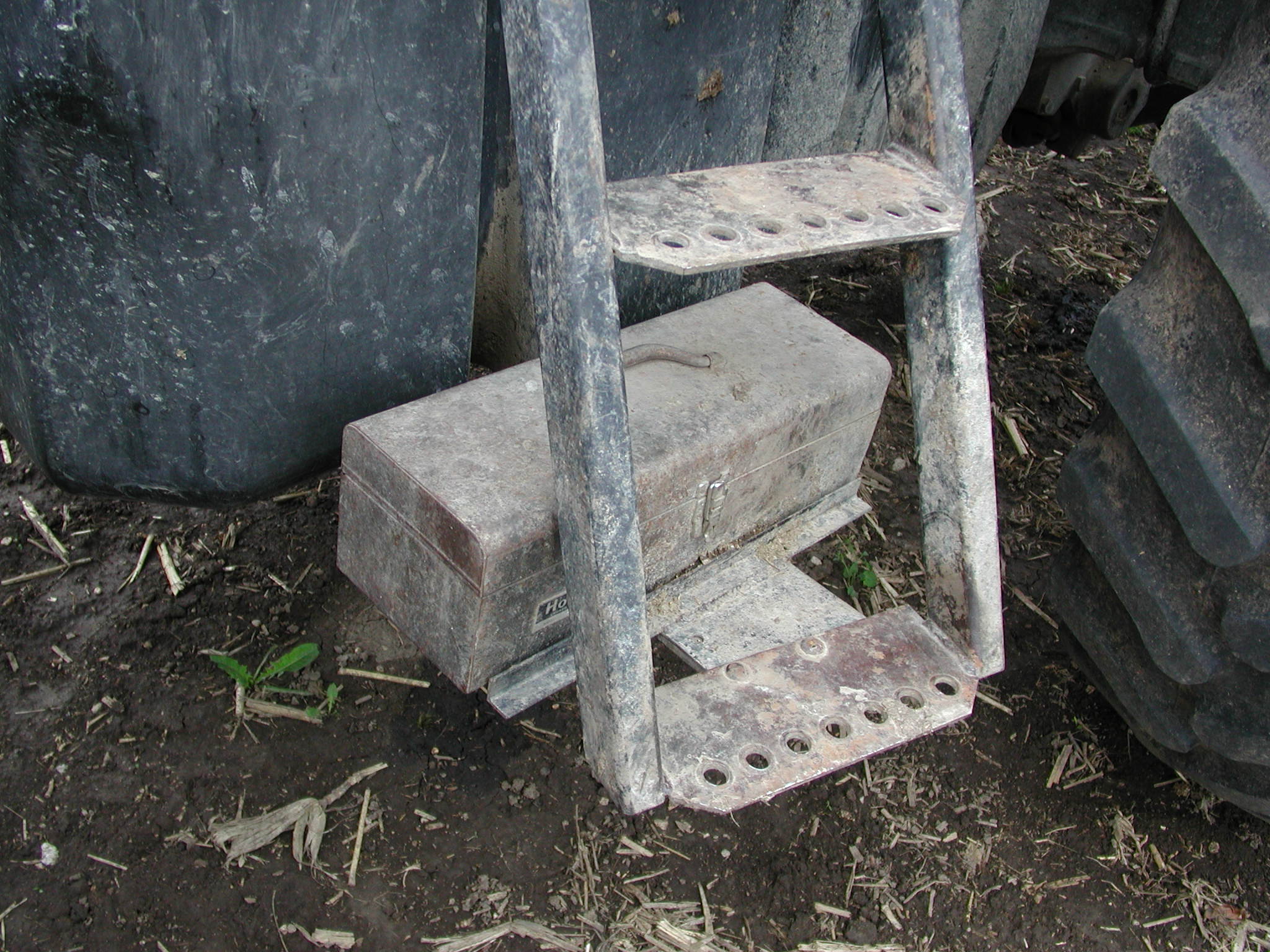

Here are a couple closer pictures of my toolbox.  I put studs out the back of the box with wing bolts so it is secure, but easy to take off when needed.
My Allis dealer sold the fenders to me.  He had done a 8050 for another customer.  They are Ford, but I'm not sure what model.  Have to drill and tap two 5/8" holes in the tractor FWA housing.
