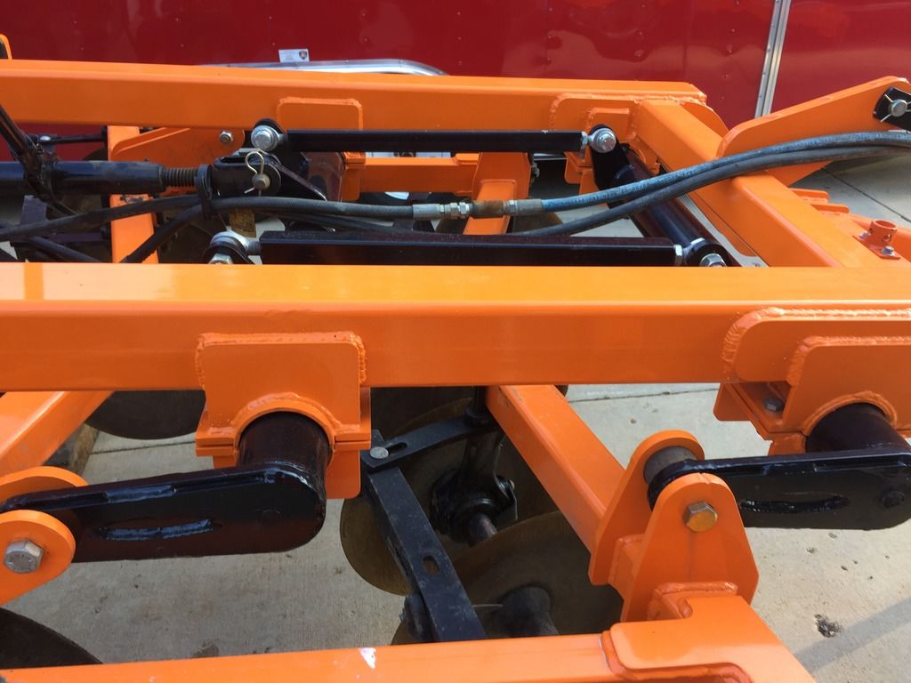

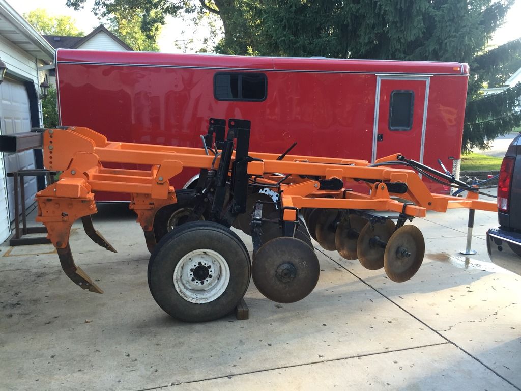

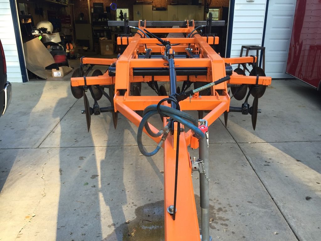

A friend and I built this for his dad's farm. It's some old Allis 80 series trip bottoms with home made points and the disc sections are the wings off a Deere disc. Takes about 130 ish horse tractor to pull it deep but a lot of the slow draining areas in his fields drain much better.

That is super nice bigredisb! How much time and money do you have in that? Do you have any other pic of it? Thanks

Since it was all parts and pieces laying around I don't know what my friends dad had in it. The powdercoating was the most expensive part I think.
Here is some working video of it. I was pulling it with a 140hp MFD tractor and it was giving it a work out. This was after my buddy designed the rolling baskets for it.
Disc Ripper Testing
First Test
V8 Massey trying to pull it
Back to the original poster scenario this tool was built because we had a hard plow pan that we were not getting through and in some areas the moisture wasn't even getting to the tile below it.
