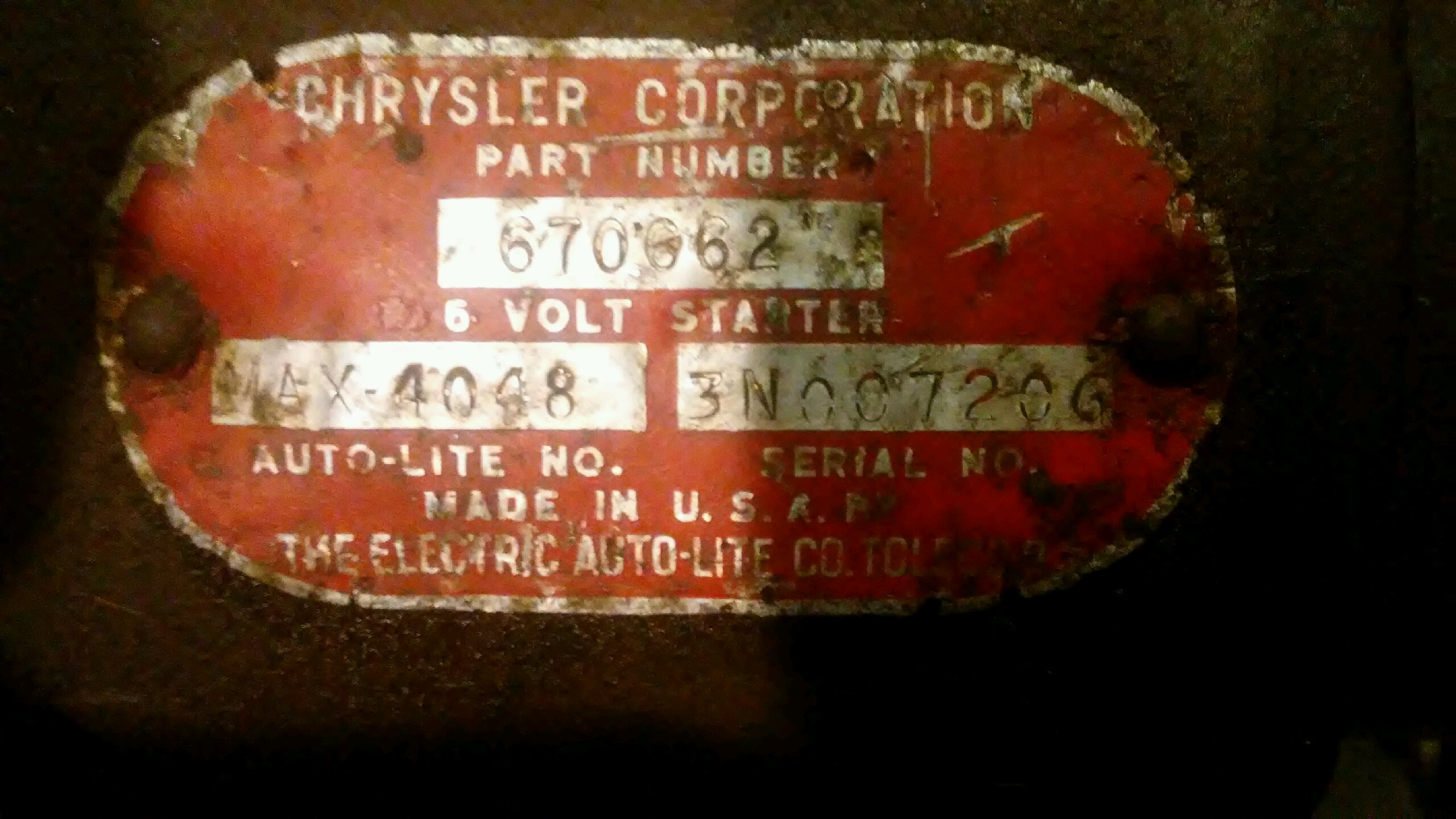

Post Options Post Options   Thanks (0) Thanks(0)   Quote truckerfarmer Quote  Post ReplyReply Direct Link To This Post Posted: 28 Feb 2020 at 6:56am
Here is a picture of the tag on the starter. He said the armature ha worked it's way back and got against the brush holders and bent them.
I would really like to update to a 12 volt, but if all else fails will have this one rebuilt.
Steve, thanks for the offer to rebuild it. If you can come up with the parts to do it let me know.
Points: 12071
Post Options Post Options   Thanks (0) Thanks(0)   Quote Steve in NJ Quote  Post ReplyReply Direct Link To This Post Posted: 28 Feb 2020 at 11:38am
I don't for see any problems rebuilding that unit. Coarse, I need to tear it down and access it, but I have parts for that Starter. As far as changing that particular unit over to 12V, that could be a different story. I could build it 6V and have the rewinder wind it a little better to handle 12V. As long as your not crankin' on it for long periods, it should be fine. I can build it to handle 12.
