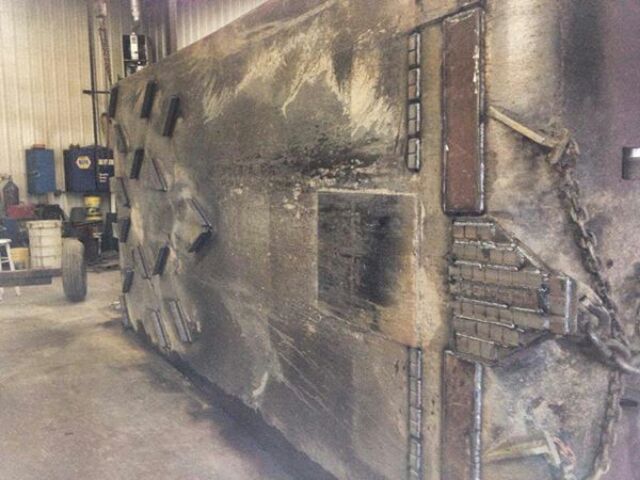

Heres kind of a neat pic i seen on FB, the underneath of a sled- kinda see what stops you and it fabricates the track conditions its self!
