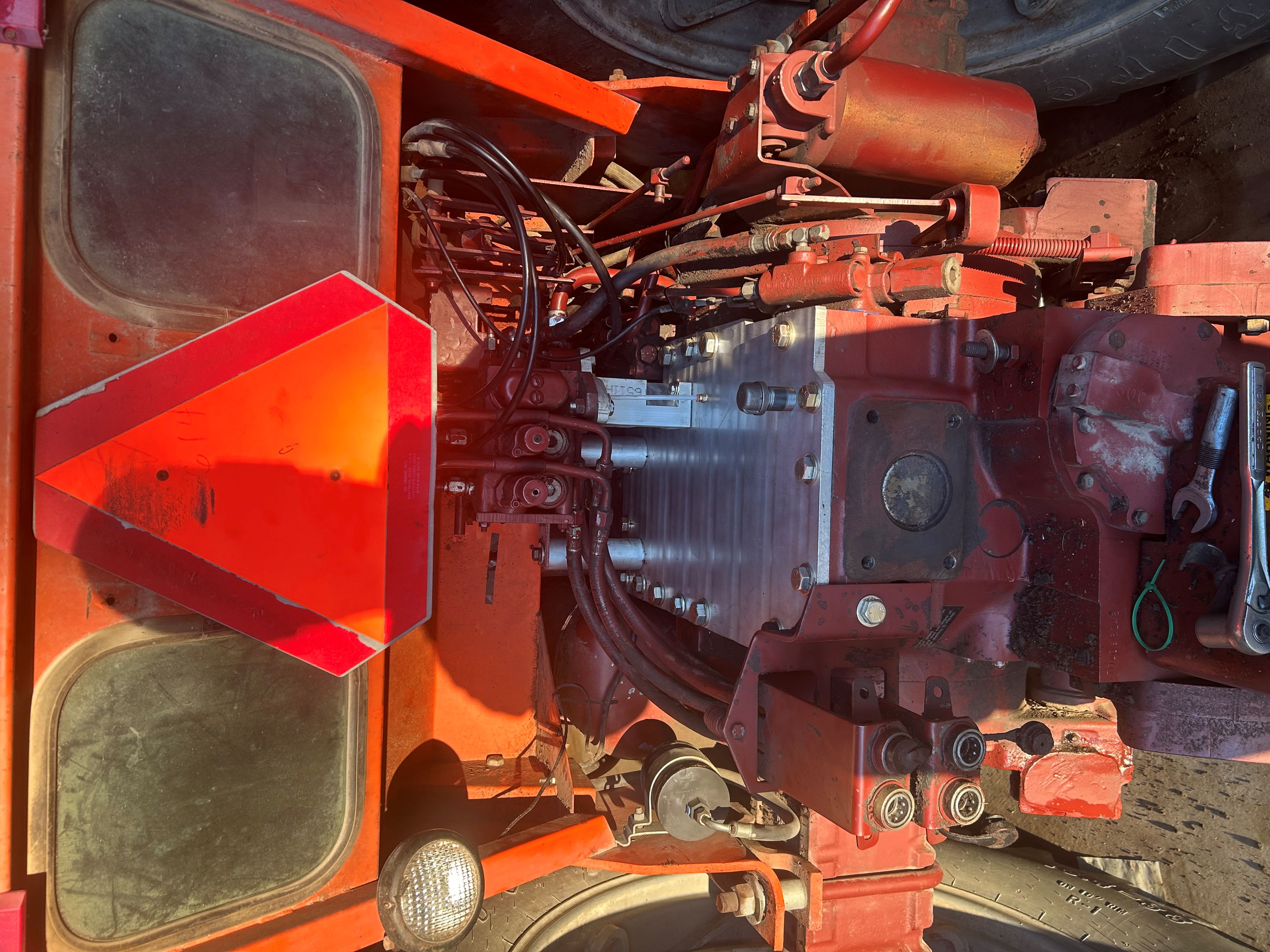

Have her new shoes on. Started taking cab off this morning. Hard decision when the cab is in such great shape! Any cab removal tips welcome. Will be converting to open station.

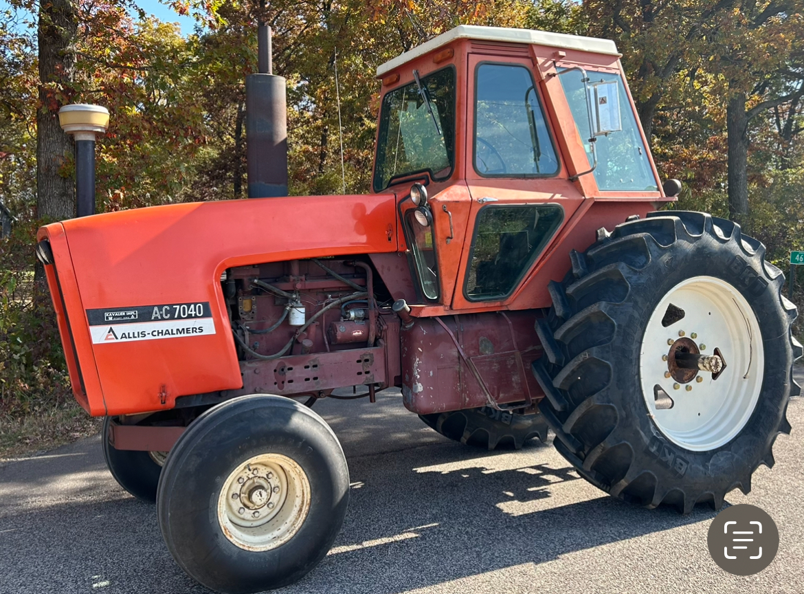

Were those extended mirrors a factory accessory? Note the little AC decal on there.

Yes, original mirrors. Correct, making a puller.

The mirrors were not factory installed, they were added by the dealer or purchased from a dealer and then added.

Any hidden bolts that I should be aware of?

No hidden bolts that I remember.
