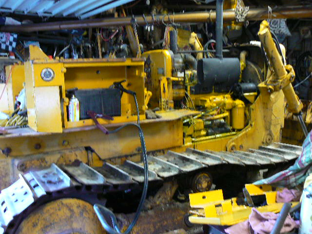

Post Options Post Options   Thanks (0) Thanks(0)   Quote giz's hd-6ep Quote  Post ReplyReply Direct Link To This Post Posted: 14 Sep 2010 at 8:55pm
picture of ol girl in progress little blurry workin on better shots
