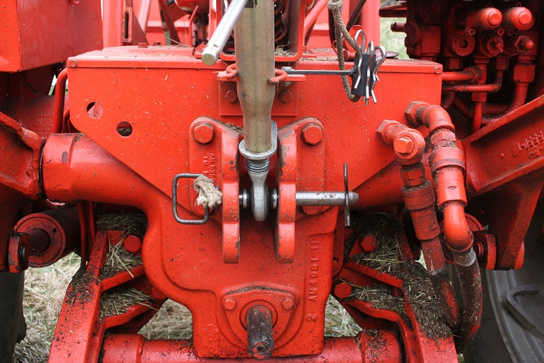

The holes on left side will accomodate 2 more remotes , but I do not know if they will work independantly of the other remotes .Some one on here will know for sure

I don't know if you can tell in the photo, but the quick connects to the loader are on the hoses not on (what I would consider) the remotes.  I don't know if this is backwards or if I don't fully understand it or maybe it doesn't really matter.  But, I think, in order to make this work, I'd have to do one of the following:
1. Buy quick connect adapters for the hydraulics hoses so that a male hose could connect to the male remote and then block up the loader every time (or take it off).  And then have some extra adapter sets around for any hydraulic implements I want to connect up to the tractor.
2. Switch around the quick connects for remotes and hoses for the loader and then just block up the loader every time (or take it off)
3. Put in a 2nd set of remotes with the quick connect set up so the hoses can snap right into them.  I'd still have full functionality of the loader if I wanted to use it (or take it off).

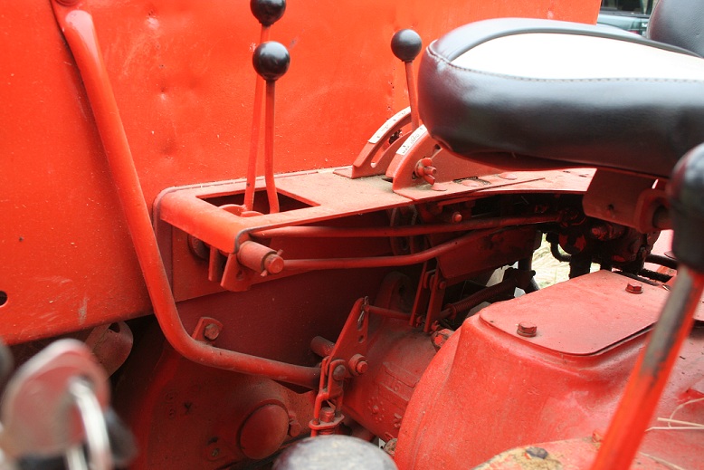

I'll see if I can find a picture of it on one of my other computers, tomorrow...or rather later today.
Here's the controls for the 3-point and remotes (outside=3-pt up/down, inside= 3-pt/remote selector):

Travis,
I think these are the photos you wanted.
