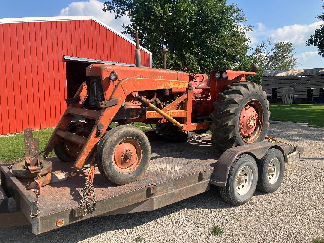

Craigslist finally paid off, it seems to be dying a slow, agonizing death. Anyway, found this D-17 on there and it found it's way on the trailer and home with me. it has some good points and some not so good. On the not so good, carburetor was in the toolbox and a Zenith. Shouldn't these be a Marvel/Schebler? Pretty sure I have all the parts I'll need to get it running. Not just sure what I'm even going to do with it yet so stay
posted.

Look in pretty good shape. I like the square fenders

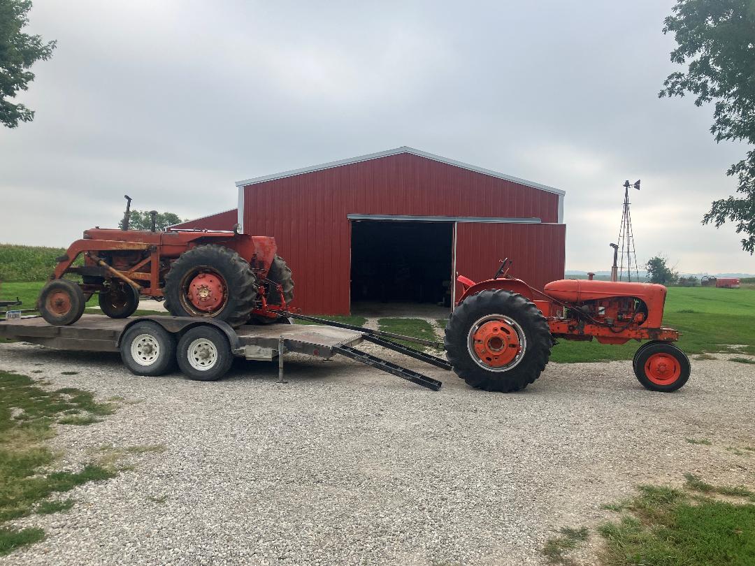

I have located all the parts to build a tsx 464, (I think). My plan right now is to put it together and get it running, then get a kit and rebuild the Zenith that was in the toolbox. Keep the 464 on the shelf ready to go as most of these things seem to need one when I find them! I'm not too big on the chinesium stuff. Did put one on a Cub Cadet once and it worked but will stay with rebuilt original.
Edit; I should add, yes the loader really should come off at least until it's working correctly! Probably sell the loader as I don't need it at all.
Couple of pics unloading/moving to temporary spot until it moves under it's own power.

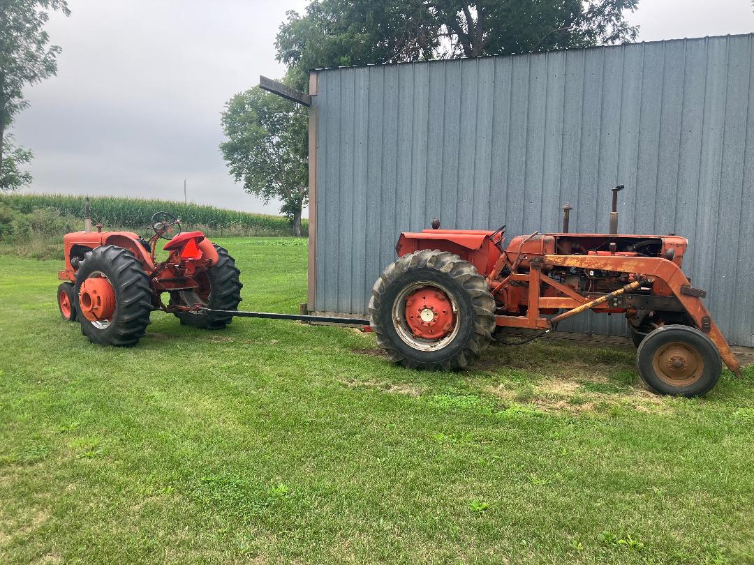

I like that tow bar with two hitches.

Yeah, I don't usually rob one but in this case.... This thing is still a 'pig in a poke' so to speak. Until it runs and I know more about it, trying to keep the investment minimal.
That 'drawbar' is one I built after seeing the one Andy Guebels had. I bought a WD off him years ago, non-runner. He pushed said WD on the trailer with a 190 using one like this one. Built mine shortly after returning home!

I hope you get it running this weekend. That would be great! I like that push/pull bar too.
