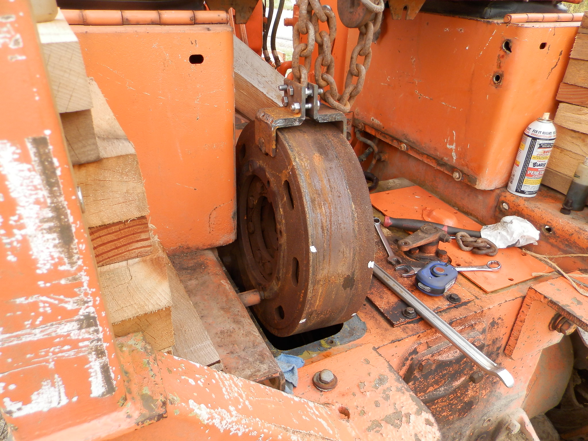

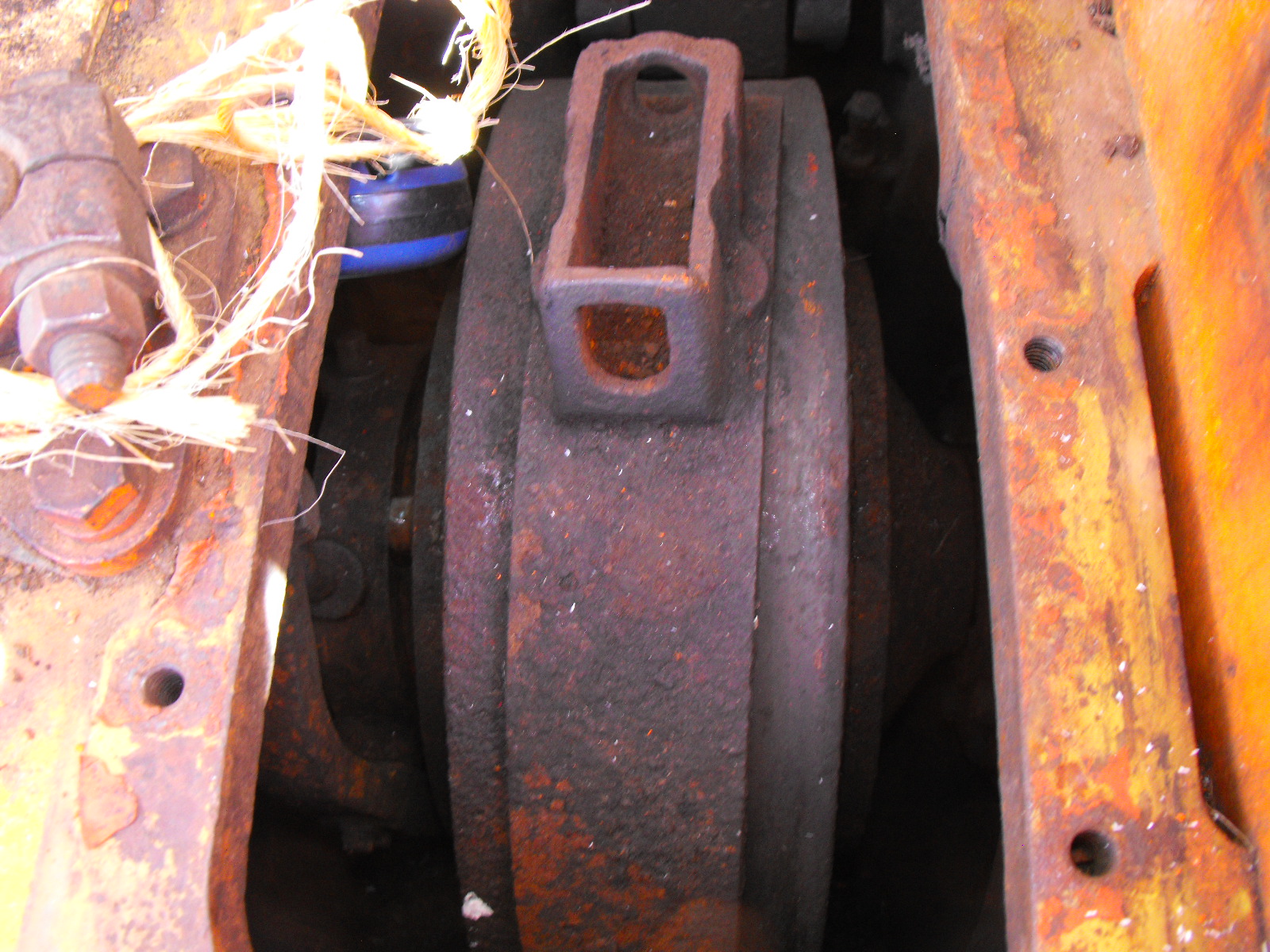

I repaired the left steering clutch on my HD6E. I removed all bolts but one on the right side. It is the long bolt on the throughout side. It is rusted smaller than the 3/4 hex. I tried the box wrenches that are supposed to be for undersized bolt heads but they make the situation worse because the work only on half of the hex. If you use the box wrench upside down relative to the turning direction the cam shears off the tips of the hex. Suggestions please

rotate to top of unit , use a socket (cheap impact type) one size smaller and use Dremel tool and grind it to fit the bolt head inside . Or try grinding down head of bolt to fit 11/16 socket

If I am reading this correctly you are wanting to remove the bolt, (capscrew) shown with rounding edges securing the driving flange to the clutch hub. If so that bolt is only about 1.750" in length and IIRC 1/2X13tpi.
I would heat that bolt head red with a torch till dull red, and with a can of penetrant lubricate where the bolt shank meets the clutch hub. Give a couple of minutes for the oil to creep, and do it again. Once cool and with a blunt punch of some sort of adequate length, smack that bolt head in the sides around it's circumference to get some movement though shock loading. Once this is done then try the pipe wrench, or vice grip routine to twist it out but once free, gingerly loosen, then tighten it back up, then loosen some more, get oil in the gap between the bolt head and hub, then tighten again. Not a lot of room in there so you really don't want to take the head off leaving the shank.

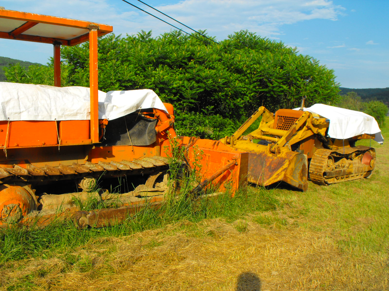

I am using my HD6G to move the HD6E to position the steering clutch bolt
in the best position for whatever comes next. It has been in the 90's

Post Options Post Options   Thanks (0) Thanks(0)   Quote Dozer987 Quote  Post ReplyReply Direct Link To This Post Posted: 20 Jun 2024 at 5:58pm
I took my photo into paint to make it fit better

Installed 2 adjacent bolts as suggested. Used a cutting torch to heat clutch hub cherry red. shocked the bolt. Used 19 mm 6 point box wrench to remove the
"Last Bolt" The picture does not show the mouse nest. Thank everybody for the advise.
