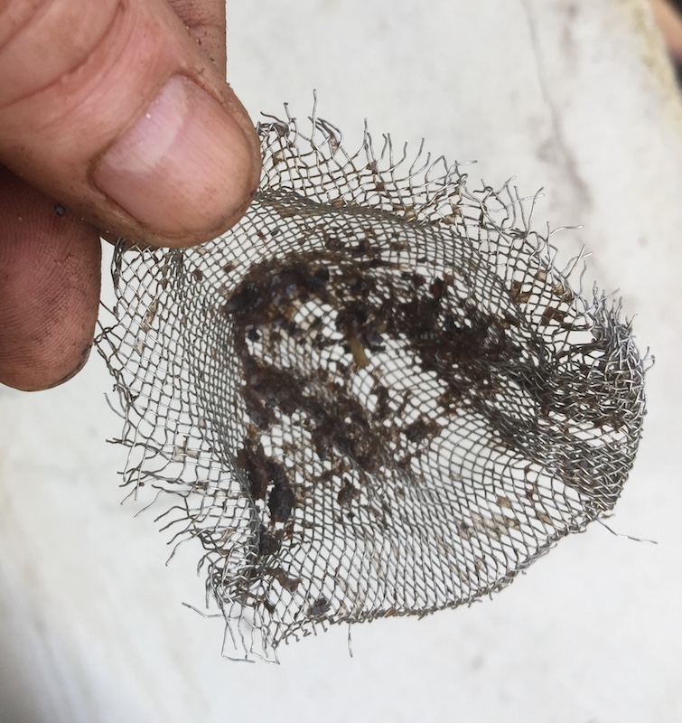

Got out and fired the B up again this morning, and she won’t need applying the choke unless it is really cold. I choked it full closed on one crank and then opened it to half way. On the next compression pull she fired right off, and started stumbling in 10 seconds or less! As soon as I opened it up she smoothed right out, but it is at least 60° here this morning. The exhaust has cleaned up really well and only puffs every now and then when it misses, which isn’t often. Running wide open she doesn’t miss a lick. I can tell by the way the cranking feels that runnng for a while has freed up bearings, rings and such. Between compression pulls the engine just falls over now, and there was some resistance before.
The oil pressure gauge is officially shot. I know because I attached one of those induction tach/hour meters where a wire is wrapped around a plug wire and the pressure gauge neddle doesn’t move off zero at any rpm. There isn’t any rattling, or bottom end rumble, no matter how slow or fast the engine is turning. The loose radiator makes more noise than the engine rotating/moving parts.
The engine idles down to around 800 rpm and tops out at full throttle at almost 1,400, so I know the governor is working. We’ll see for sure when I get her rolling and put a load on it.
My DIY coolant filter made out of screen wire mesh did catch some crud, but no rat nest stuff. A few big beetles, a couple spiders and rust flakes was all it had in it. I cleaned it out and reinstalled it just to be sure. I think running some flush juice through it might be a good idea.
I let the B run for about an hour today, and varied the rpms every few minutes. I know I should run the valve clearance, and I will after the next run. The oil has turned a little brownish, but the level hasn’t changed. After I run the overhead and get antifreeze in her I will probably change that oil out and probably get another filter on there.

Here is my DIY coolant screen filter I jammed into radiator the inlet to catch junk. This is after the second run and has about 1/4 as much stuff as after the initial startup.
