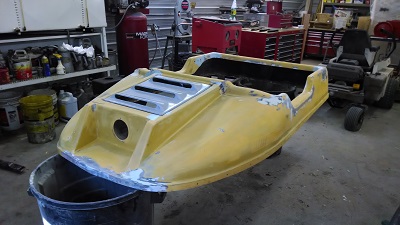

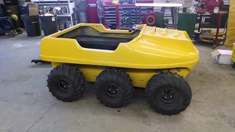

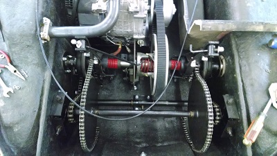

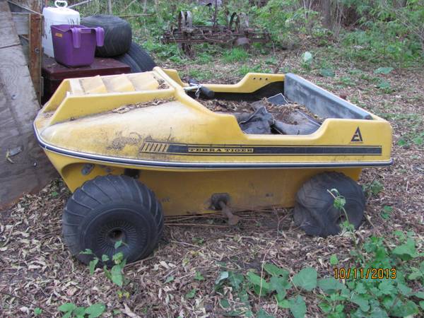

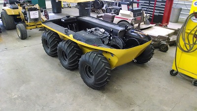

Just thought Id share some photos of the progress on my TT10 Terra tiger, Im just waiting to finish sanding and painting the top half now, I completely disassembled the machine and sandblasted all the axles, sprockets etc. It now has all new bearing and bushings a 14 hp Subaru, new Carlisle tires, wheel adaptors by Adair Argo, the clutches were relined through Farmtoybuilder, and the new hood is from route 6x6. The body was in very rough shape when I got it and I used a whole tube of Ever Coat fiber tech and almost a tube of icing to fix it all. It is painted PPG Delfleet John Deere Constriction yellow

louvers on backwards?

And louver openings should be to front to allow air to cool engine and clutches some.

Post Options Post Options   Thanks (0) Thanks(0)   Quote ajossund Quote  Post ReplyReply Direct Link To This Post Posted: 19 Jun 2014 at 9:43pm
Got all done painting tonight now just for decals and the trim! getting excited!!
