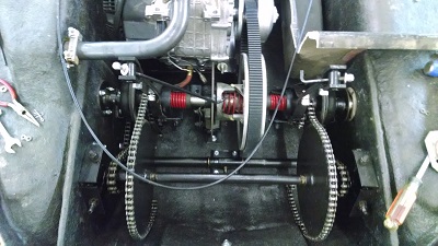

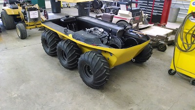

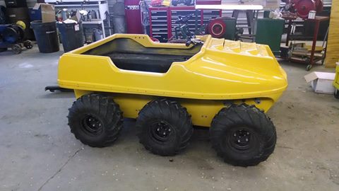

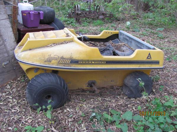

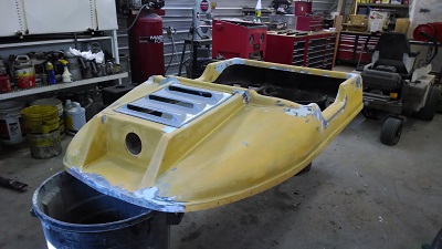

Just thought Id share some photos of the progress on my TT10 Terra tiger, Im just waiting to finish sanding and painting the top half now, I completely disassembled the machine and sandblasted all the axles, sprockets etc. It now has all new bearing and bushings a 14 hp Subaru, new Carlisle tires, wheel adaptors by Adair Argo, the clutches were relined through Farmtoybuilder, and the new hood is from route 6x6. The body was in very rough shape when I got it and I used a whole tube of Ever Coat fiber tech and almost a tube of icing to fix it all. It is painted PPG Delfleet John Deere Constriction yellow

louvers on backwards?

And louver openings should be to front to allow air to cool engine and clutches some.

Thank you! Its definitely been a learning process when it comes to painting and body work, I made many a trip during my lunch break at school to go over to the local auto body supply house!

Thanks! its been a lot of sanding and body work that for sure!I just primed the top half last night ill post pics when its on!
