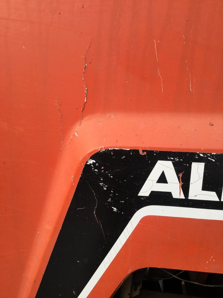

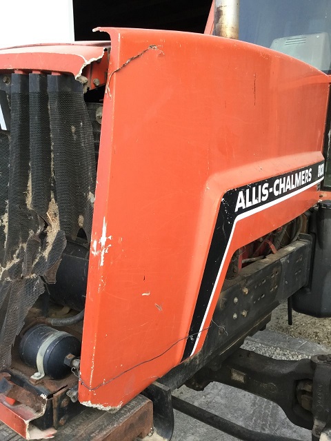

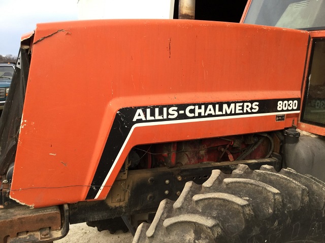

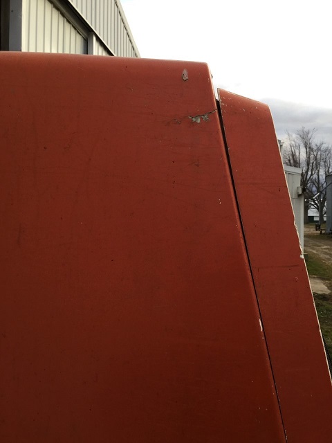

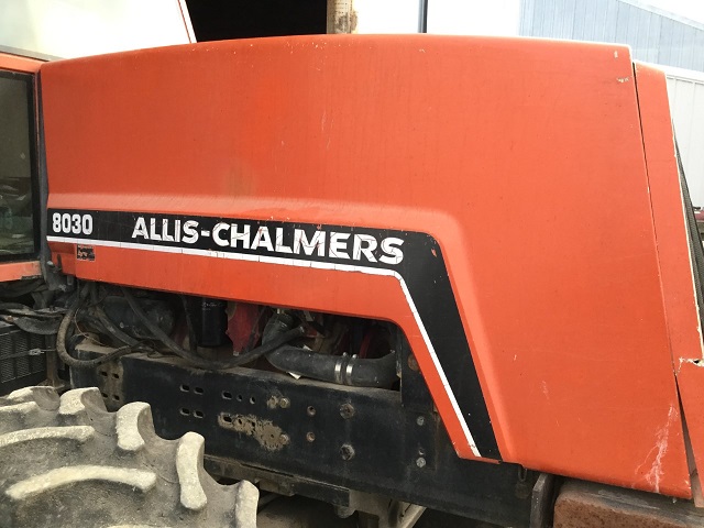

Post Options Post Options   Thanks (0) Thanks(0)   Quote Jordan(OH) Quote  Post ReplyReply Direct Link To This Post Posted: 07 Jan 2017 at 9:08am
Right side isn't too bad but left is pretty beat up.

Post Options Post Options   Thanks (0) Thanks(0)   Quote Daehler Quote  Post ReplyReply Direct Link To This Post Posted: 07 Jan 2017 at 11:43am
Them panels and grill have seen better days

Post Options Post Options   Thanks (0) Thanks(0)   Quote LeonR2013 Quote  Post ReplyReply Direct Link To This Post Posted: 07 Jan 2017 at 3:20pm
Them ain't bad at all. Very easily fixed because of them being fiber glass.

Post Options Post Options   Thanks (0) Thanks(0)   Quote Unit3 Quote  Post ReplyReply Direct Link To This Post Posted: 07 Jan 2017 at 6:45pm
This is more of bump for a friend than anything, but, what kind of red engine is under the hood with a starter on the right side?

Post Options Post Options   Thanks (0) Thanks(0)   Quote Jordan(OH) Quote  Post ReplyReply Direct Link To This Post Posted: 07 Jan 2017 at 7:45pm
It's a CIH cotton picker engine, aka, 8.3 Cummins.

Post Options Post Options   Thanks (0) Thanks(0)   Quote Transaxial Quote  Post ReplyReply Direct Link To This Post Posted: 29 Jan 2017 at 2:21pm
I have a 8070 MFWD and have a Ezee-on loader on it that allows the side panels to fit normally. As far as fixing those fiberglass panels, it is not very difficult to do yourself and they will look like new when you are done, just a little thicker! Bonus. Or take them to a body shop. Naw, too expensive. Get some different weights of fg cloth and then some resin and hardener. Two part catalyst type resin. Do not mix up more than you can use in 10 minutes or so, and just start laying on layers of reinforcing cloth on the back side. Let them set and then do another layer until the panel is good and strong. If sections are missing of the original hood just remake them using cloth and resin. Make sure you soak the cloth all the way through with resin. For the front side, fill little crack lines with resin to overfull and just sand off the excess when done. You can use a little skim of bondo to finish any rough spots before painting. There are lots of good videos on youtube. It is amazing how a few hours and a little bit of materials can rebuild a pretty ugly old panel, and make it look like new.
