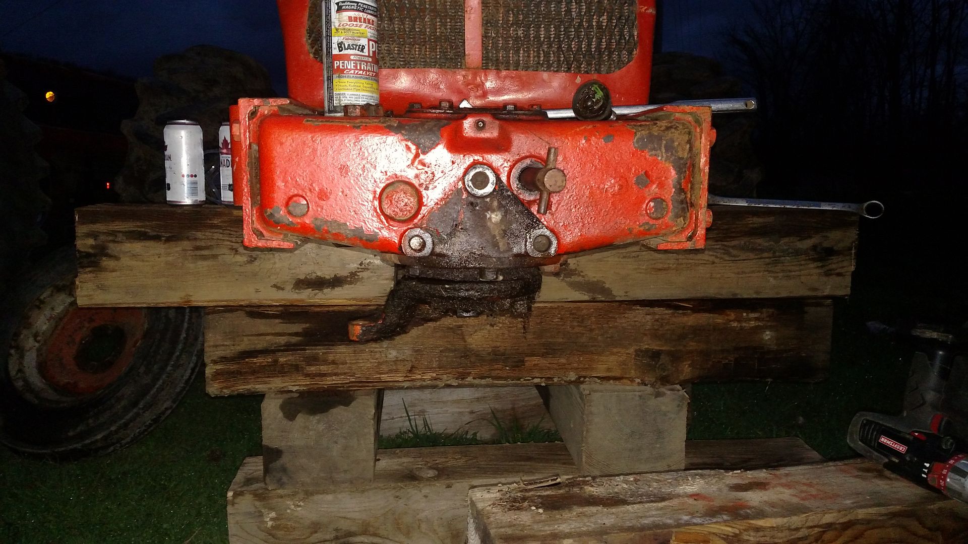

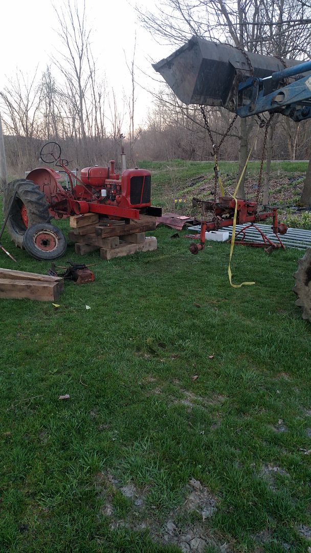

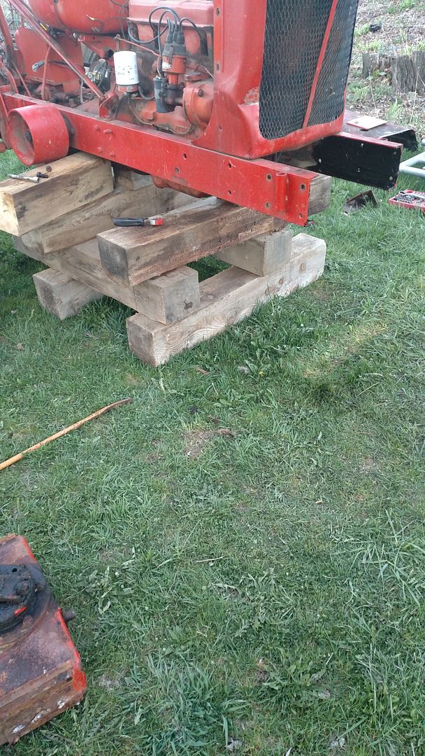

Post Options Post Options   Thanks (1) Thanks(1)   Quote Huckleberry8961 Quote  Post ReplyReply Direct Link To This Post Posted: 06 Sep 2016 at 11:01pm

Thank you for the pictures. Very nice job on the wooden block arrangement. Yes its true that i lucked out on the bolts holding the casting..... But i have not yet started disassembly of the narrow front wd45. I may be in for a big job. But hopefully not.

Using a wrench and hitting the upper end of it with a hammer might help. The bolts I seemed to have the most problem with was the ones that bolt the steering gear box to the frame. Ended up with three broken trying to use a long handled ratchet and getting in a yank.
Thanks, and couldn't think of a better way so I used what I knew from work. That configuration is how we use the cribbing to hold houses up when we redo the foundations.
