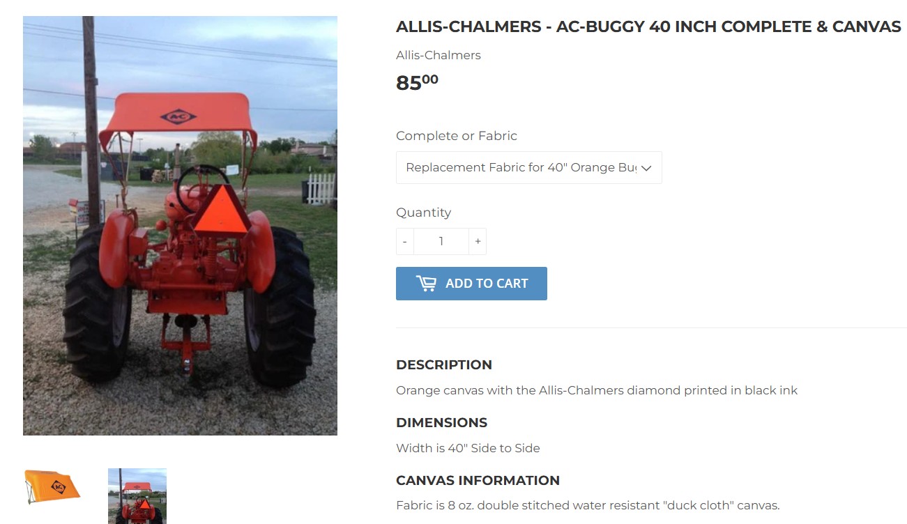

I have a narrow front D14 that I mounted a small spray tank on the back. I intend to use it for spraying ditches this summer since it will go through taller corn than my atv.
I’d like to mount either a “buggy” style shade or umbrella. The 30” fender width seem too narrow for the 40” buggy style I’ve seen.
For those of you that have such a setup, how did you mount the frame of either style? Pics would be great if that is possible. Thanks in advance for the help

I have had a 40" buggy style sunshade on my D15 and it fit nicely. I currently now have it on a D10. If you get the shorter "fender" mounts instead of the "axle" mounts you can swivel  the attachment point out to the needed width.
Points: 89960
Post Options Post Options   Thanks (0) Thanks(0)   Quote steve(ill) Quote  Post ReplyReply Direct Link To This Post Posted: 07 Jun 2025 at 8:44pm
https://tractorumbrellas.com/products/allis-chalmers-ac-buggy
