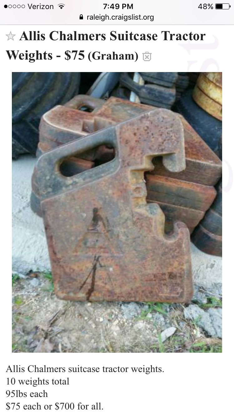

What do these fit? Sorry for the link I can't figure out how to post the picture. I am looking for weights for my 200 and found these locally. I didn't know if they would fit on the weight bar of my 200.

Those are the 7000 series
Will not fit the 200 weight bracket

Those look like 6000 and 7000 series weights. There was 2 styles of weights used on the front of the 200. The larger ones are almost flat on the top and are used in the 210 tractors as well...hard to find. They have a weight bar with slots and use outside locks on each end like the 6000 and 7000. The other style are smaller and look like the weights used on the 185 tractors. They have a weight bar that has a notch in the middle and a bar that slides through to keep them in place.

Thanks for the replies yes my 200 has the bracket with the notch in the middle and I was afraid these weights would not work typical for my luck because they are close to me and the seller wanted $75 a piece and has 10 of them.

Those are definitely 6000-7000 weights, I have some 200 weights and they are similar but different. Flatter on top like someone said

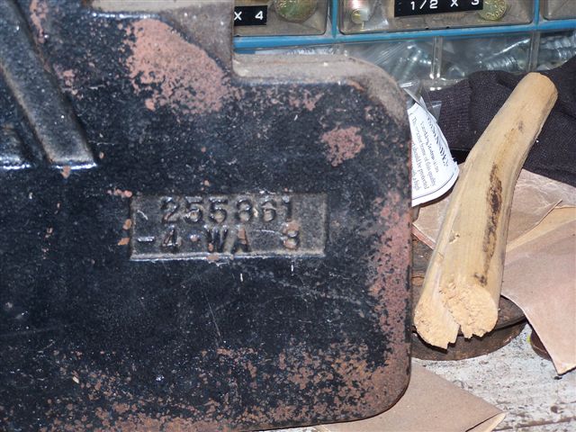

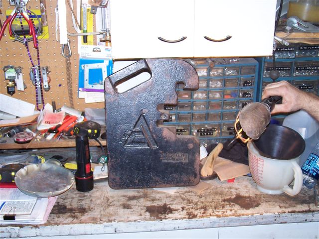

I believe this is the suitcase style weights you're looking for.  These would be original for the Model 200.  No, they're not for sale.
View of part #:

I have ones like Brian F(IL) posted that I would sell.   In northwest corner of Ohio though.
