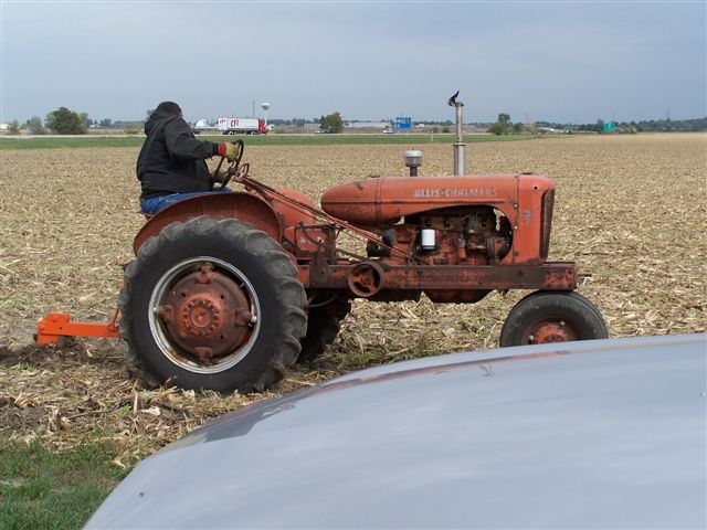

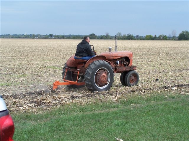

Here are a few pics of mine with the WD-45.  Got the subsoiler from Bryan I. (fellow Forum member).  I can pull it in 2nd gear easily.
