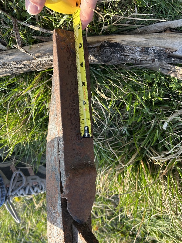

Post Options Post Options   Thanks (0) Thanks(0)   Quote Allis dave Quote  Post ReplyReply Direct Link To This Post Posted: 26 Mar 2026 at 8:55am
Here's a picture of the point. Hole spacing is 2.25"  A small extension has been welded to the back.
Maybe this point isn't too bad.

Post Options Post Options   Thanks (0) Thanks(0)   Quote Kenny L. Quote  Post ReplyReply Direct Link To This Post Posted: 26 Mar 2026 at 12:31pm
That's different then my

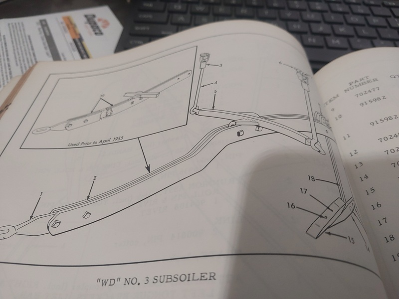

Does anyone have a manual for a #3 subsoiler? Does it have  a picture of the point or a part number?
Kenny L. View Drop Down
Location: NEIOWA
Points: 1417
Post Options Post Options   Thanks (0) Thanks(0)   Quote Kenny L. Quote  Post ReplyReply Direct Link To This Post Posted: 07 Apr 2026 at 7:12pm
Allis Dave, pm me your cell number or text me your number to the cell number I posted  and I'll text you three pictures out of my parts book. I just got a new computer and haven't got posting picture down yet. Kenny L.

Post Options Post Options   Thanks (0) Thanks(0)   Quote Kenny L. Quote  Post ReplyReply Direct Link To This Post Posted: 07 Apr 2026 at 7:14pm
point parts # is 702488

Post Options Post Options   Thanks (0) Thanks(0)   Quote Allis dave Quote  Post ReplyReply Direct Link To This Post Posted: 08 Apr 2026 at 9:33am
Thank you!
