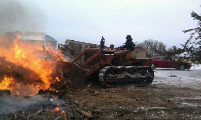

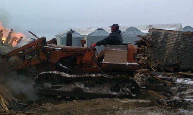

Tore down a old house next door last weekend. Thought you might like some pictures.
Sure was glad the worn shifter lever didn't pop out!

Looks like you had a grand old time Jay.

Post Options Post Options   Thanks (0) Thanks(0)   Quote Jay Tyrrell Quote  Post ReplyReply Direct Link To This Post Posted: 27 Nov 2012 at 9:24pm
I did have fun. Little scary though, it was a 2 story, i was glad when it was down. I may think bout puttin a cage on.
