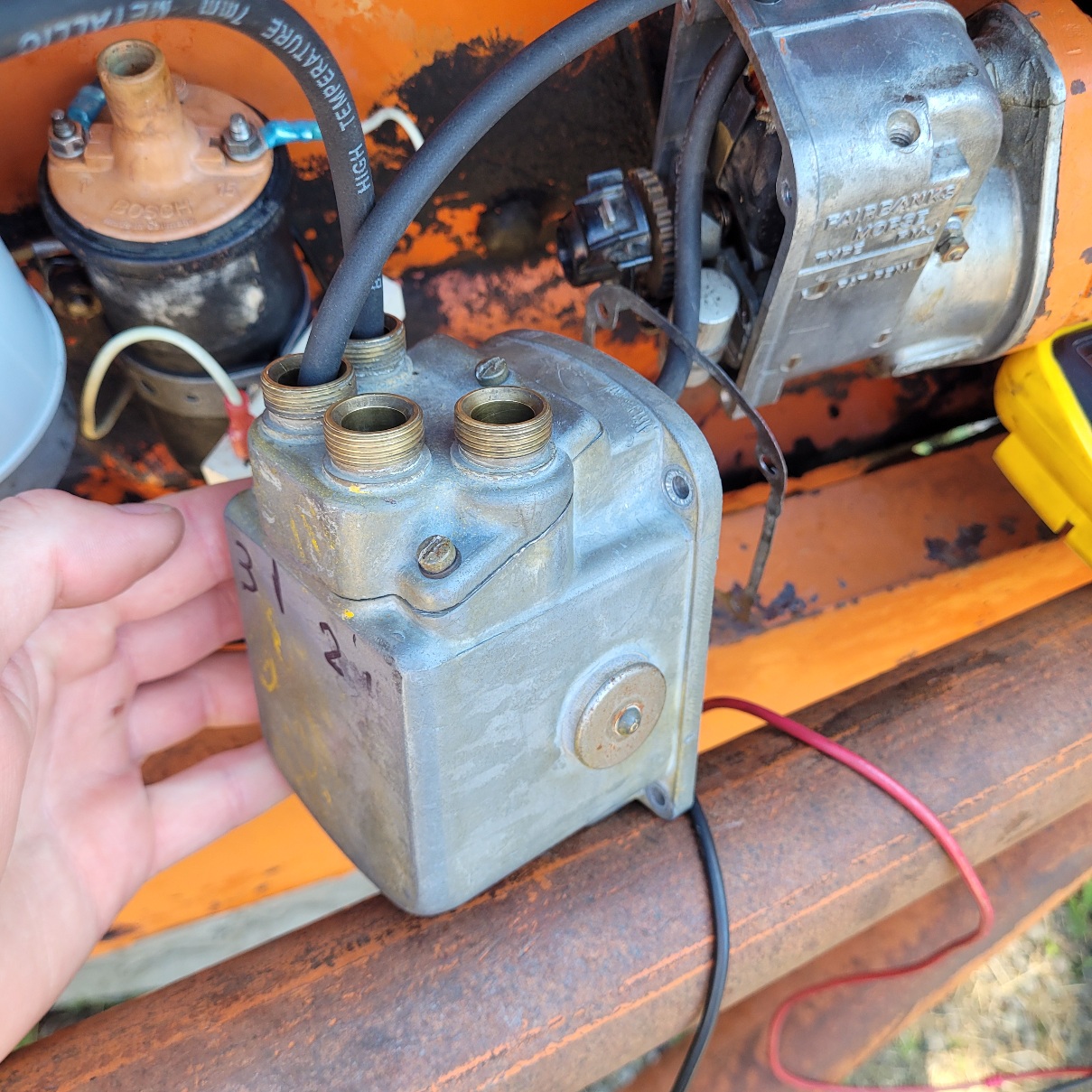

I wanted to run this by yall before I start buying parts. Recently had the WD running fantastic after some mag timing issues. Finally got it running and figured I would wash it. After washing it ran awful. Through testing I discovered the the old coil inside the mag was still firing somehow. I switch to an external Canister Coil that's an old Bosch coil. Eliminated the Inside mag coil but I now have a VERY odd issue. I have great STRONG spark on 1 3 4 but 2 is Very weak and inconstant. New plugs and solid core wires and the inside of the cap has been cleaned. I believe I set the point to 20 Thou and the coil Primary is 2.3ish and the secondary is around 9 or 10, there is resistor inline. The condenser was tested before finding that I had two coils firing haha and it tested good charging up slowly and not spiking.

Probably need a new cap.

if you have new wires and new plugs, then it is a good posibility of a hair line crack in the cap that is fireing to the next cylinder or ground... and i am NOT a big fan of inline resistors..  sooner or later you need a 12v coil and eliminate the resistor, if your going with an external coil..

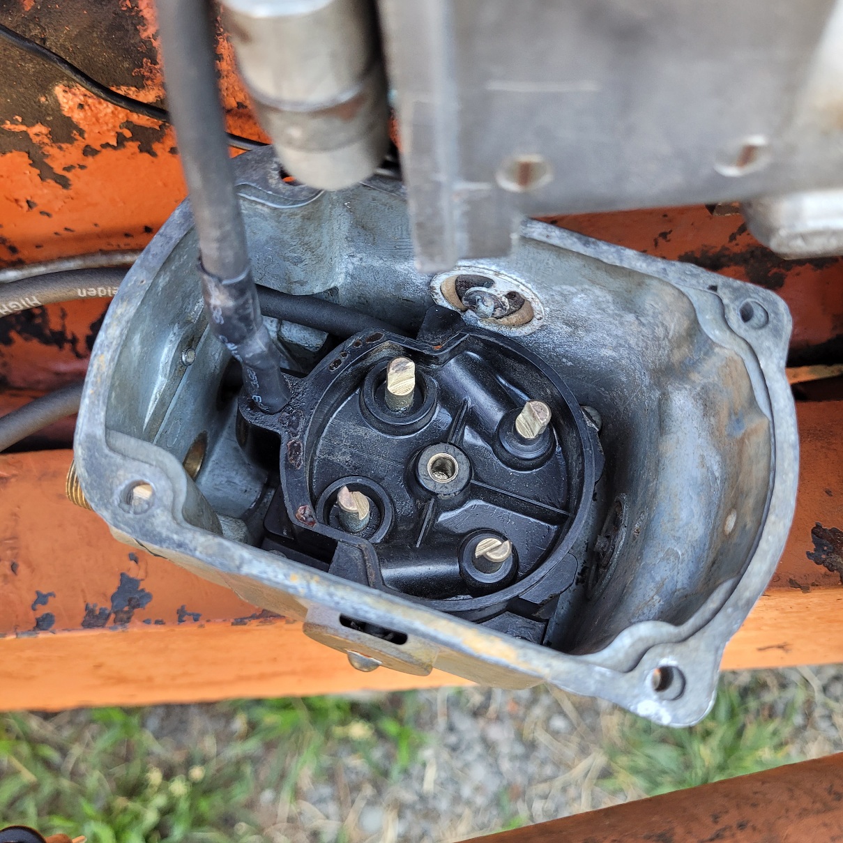

Regarding the cap if you saw my posts a while back I guess the cap that my Fairbanks Morse mag has is some 'Heavy Duty" cap. Do yall know if I can even get the inside plastic part for it anymore?

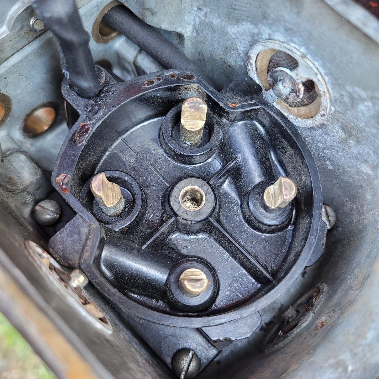

Alrighty yall it's time to dig through your stashes haha. The cap has continuity between post 2 and 4.
Does anyone know of or have the part number for this style cap?

The body of the mag is a standard fmj mag but the coil can't be removed due to one of the screws not coming out. Tried heat and penetrating oil nothin. So I guess really my only course of action is to spend 100 plus on the normal cap setup and more for the normal wire setup.

That is a flange mount F/M Powerhead Mag which is missing the carbon button in the middle for starters. Also has a damaged high tension rod. It's a wonder it worked at all. Amazing some of this old stuff. Parts for the old Powerheads are even more expensive than the standard "J" or "X' Fairbanks units. If you want a Distributor type Mag, you could move to a Wico "XH" series Magneto. They look just like a Mag but work like a Distributor. You need to run power to it like a Distributor. Or get yourself a Mag to Distributor conversion. I offer a couple kits to change the Tractor over. One with points, the other with E.I. A lot of my customers got rid of the Mag and never looked back. Me being one of them and I rebuild the damn things.  LOL!  Parts are getting junky for them (even from F/M) and for a $150-$200 more than a repaired Mag you can set yourself up with a Mag to Distributor conversion kit.  Done deal.
