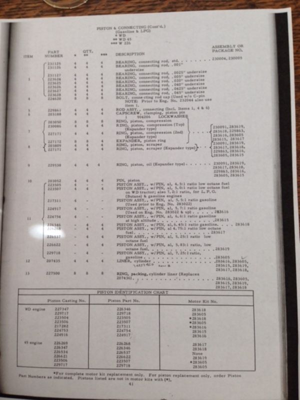

Do you know the piston number that's inside the piston?
If it's a number 223506 it's the same piston used in both low octane fuel on WD Tractors with 5.0:1 ratio; and 7.2:1 ratio for L.P.G. (Butane) & Gasoline engines used in the WD45 tractors.

  The piston casting number is 229717 and the part number is 229718.  These are the 7.25:1 compression ratio pistons.

Piston # 229717 is a Power Crater piston for a D 17- 7. 25comp. ratio.  I have a complete NOS set of those with sleeves, rings etc.

Post Options Post Options   Thanks (0) Thanks(0)   Quote Don(MO) Quote  Post ReplyReply Direct Link To This Post Posted: 17 Dec 2016 at 11:48am
This might help.
