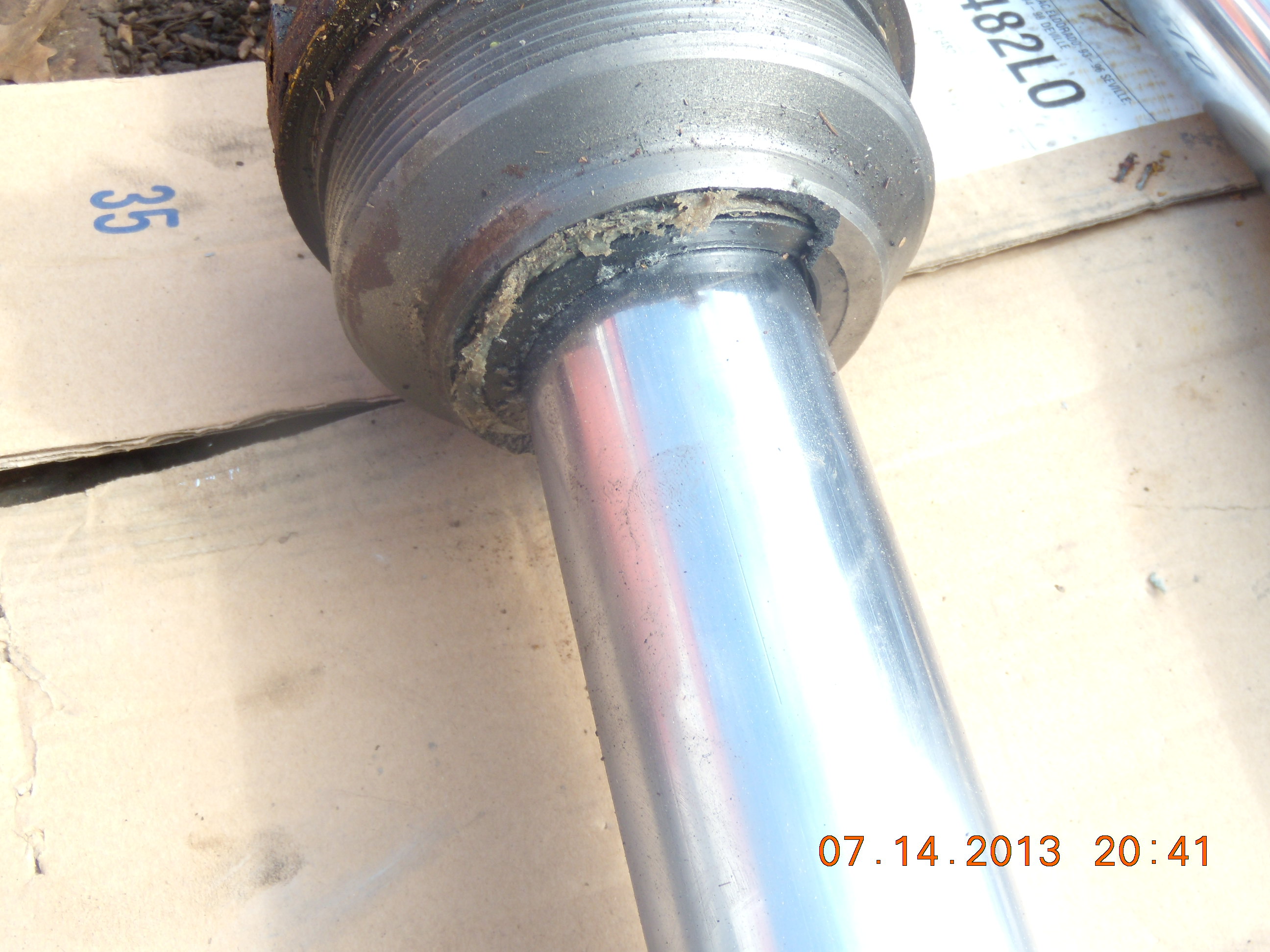

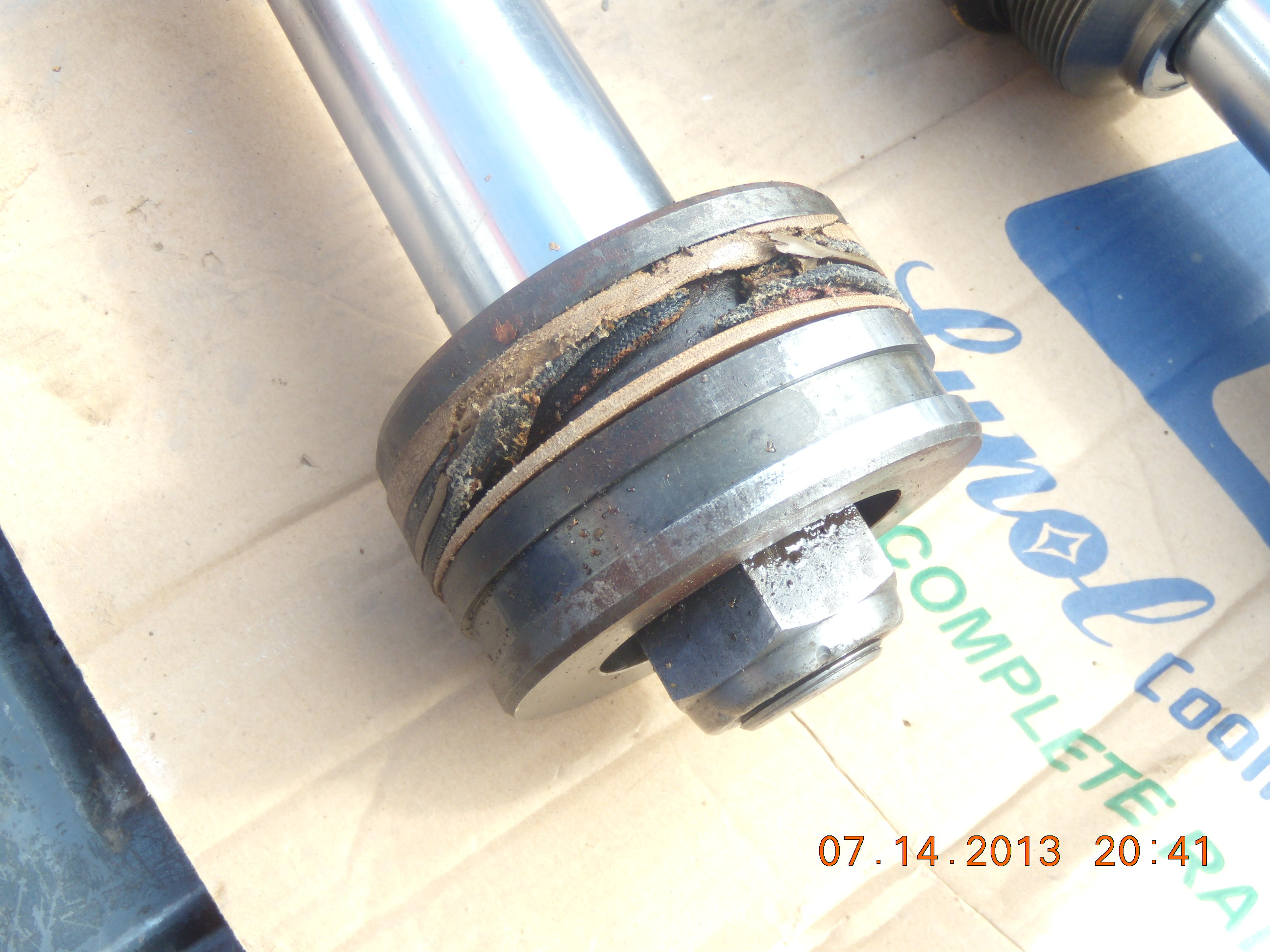

  Here are a few pics of the packings from my rams. I pulled em apart this weekend out in the sticks. It's hard to believe this shovel worked so good with these packings. The bucket rams had been resealed sometime in the past, and it looks like they cut the packing rings diagonally and installed them like on a automotive transmission. The lift cylinder packings are destroyed and you can see the broken area on the head where the shaft packing is pushing out a bit. However, this head did not leak fluid. The rams were pretty heavy for one guy to lift but two would be a snap. The piece of metal broken off the ram head was nowhere to be found....Ouch

  On my post, I was going to ask you guys about this broken head. I was thinking about it, and I'll guess that this damage could be done by someone blocking up the shovel by putting boards under the rams, instead of directly supporting the shovel with timbers, or blocking bracket on the shafts. Or maybe a piece of rock or wood got between the cylinder and the frame on power down and cocked it badly.Ouch

By the looks of it there was a hammer involved removing it in the past, to cock the cylinder enough to damage that piece would destroy the rest of it.

  You mean, as in, hammering the head on or off the shaft? Anyway,, I got the nuts off the rams and my packing kits should be here in a day or two with new bearing rings. Hey I love that OROPS on your second ( I can't bear to use the word, "donor") 7G. If it didn't take an act of congress to install it (and maybe a crane.hah) it would look good on mine. Once I get the hydraulics straightened out I'll be spoiled rotten. I'm lookin' at an old D8 to buy and use it to bust up stumps and rocks instead of this loader. Maybe sometime I'll pull the trailer out your way and pick up some goodies. Actually, that OROPS wouldn't look bad on an old D8, eitherConfused

The ripper cylinders (local Aust production, not Fiat) had V-packs that looked a bit like yours.  Took the bits to a recommended hydraulic supplier, who said "The wrong packings and they haven't been made for 20 years or so".  Correct parts no problem.
