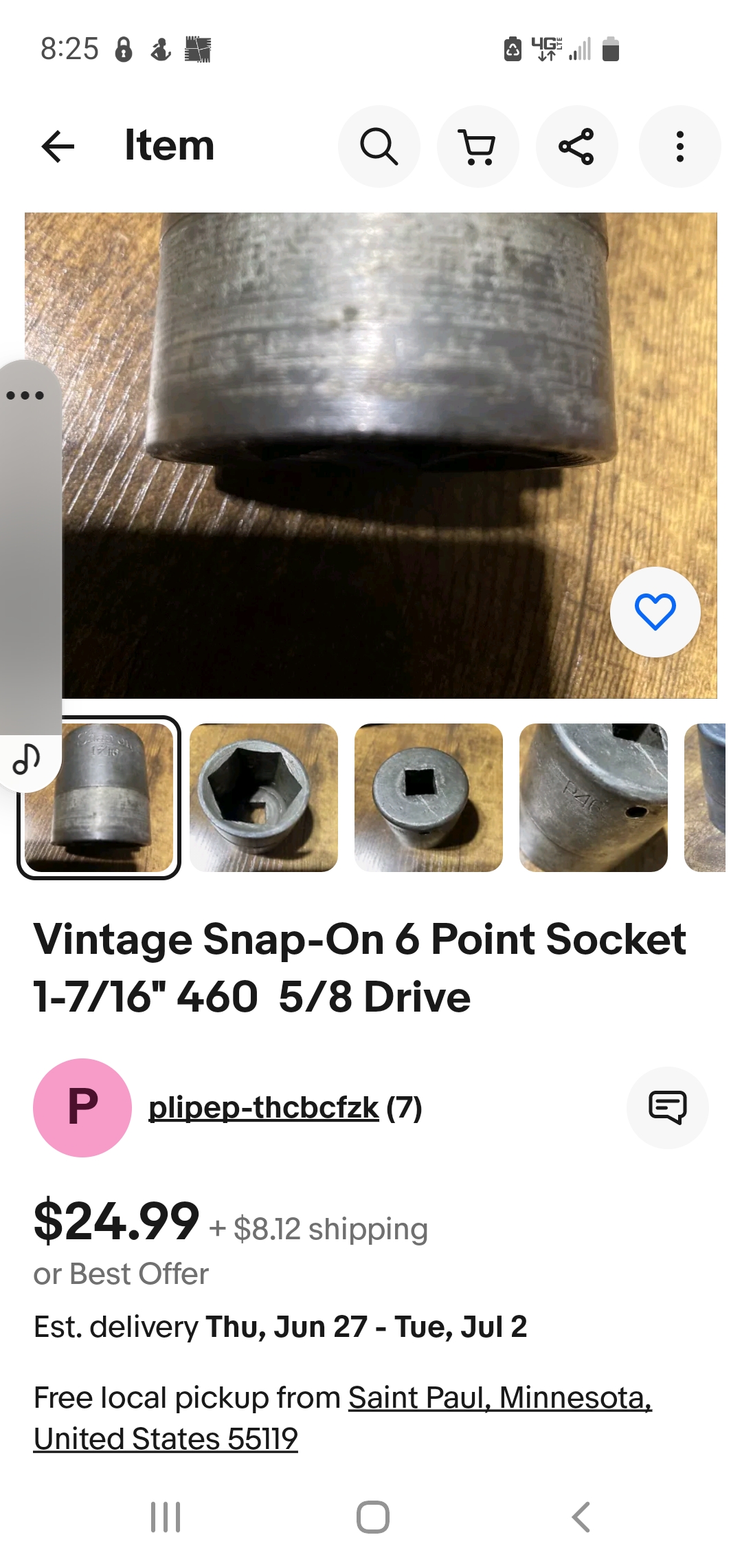

 There were some 5/8" drive socket sets years ago if they're visibly smaller than 3/4" but larger than 1/2".  But I haven't seen any in years.

Looks like back in the day snapon made some large sockets in 5/8 drive
