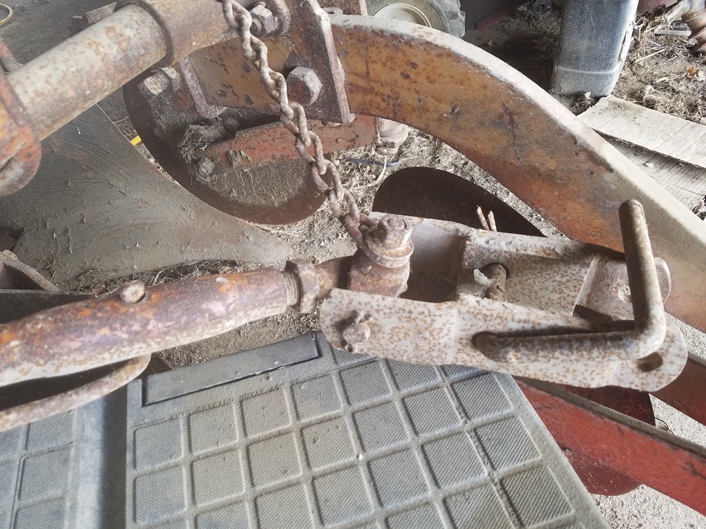

New to the forum and have a snap coupler plow that I will be putting on a D-17 that has a snap coupler hitch. I just got the couplers for the tractor side but not sure if I have the right hookup on the plow side. I have a pic but it is too big can I email to someone who may know the answer?

The plow side of the latches should just be a rod about 3" long running perpendicular to the plow. Top of the lift earn should look like a T. Simply snaps into the lift latch. I don't think a snap coupler plow came with anything other than the lift latch style end.

Just open the picture in "Paint" on your computer and resize it to about 25%. then upload that smaller photo to the site.

That plow is for a Pin Hitch CA ! It's a Pick Up Plow designed just for the early pre Snap Couple CA's.
