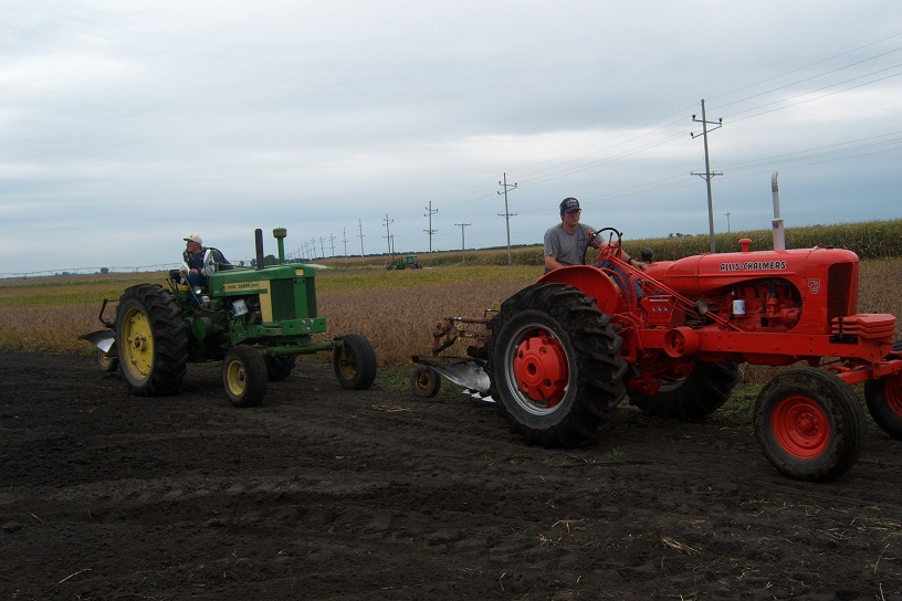

I have a 3 14" snap coupler plow that I freed up all the adjustments and replaced the sway chains last year. even with 2 sets of weights and traction boost I stil have a lot of traction issues. I have the chain set fairly tight. Should I loosen them up and let the plow follow a more natural trail? I'm wondering if I'm forcing the plow to follow a poor draft path.
Here a picture of me and grandpa at plow days last fall Since I know everyone on here loves pictures Wink

One reason your plow is pulling hard is that it does not have a land polish yet.  As the plow brightens up from use it will pull remarkably easier.  I have a WD45 weighted similar to yours, but I have fluid in the rear tires, and I pull 4-14's with it.  The ground you're in looks like it would be easy pulling.

THe landslides are good and after awhile the bottoms scoured up real nice. I dind't have too much trouble on the ground in the picture, it was pretty light soil, but I've had to play with the depth a lot in heavier ground.
THe plow seem to follow pretty straight, but does pull on the chains sometimes. The wheel spacing's set about right.  The first bottom makes about a full cut or a little under. Any tips on how to make sure the plow is set level as far as the right and left side?
I freed up all my adjustment screws but I have a tough time telling if it's level or not as the ground changes.
