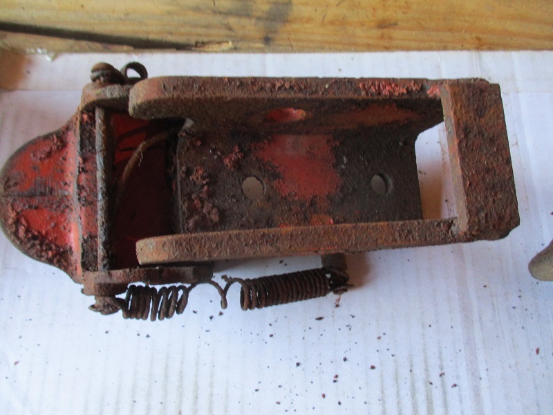

The early CA latches were different in appearance (as in Dave's picture) in that they had metal straps on the top of the latch claw instead of being solid cast.  As Tracy said B, CA D10 and D12 use the same size latch.

Besides the strap kind, how do you tell the difference between a B, CA, D10/12 latch and the others?
Don
Larry in NC View Drop Down
Joined: 09 Feb 2016
Location: NC
Points: 1050
Post Options Post Options   Thanks (0) Thanks(0)   Quote Larry in NC Quote  Post ReplyReply Direct Link To This Post Posted: 31 Jul 2020 at 8:38am
Shape is different.  Larger opening for lift arm.
